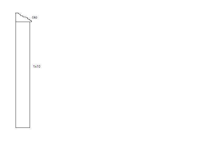

I’m going to nail a wood skirt around the outside of my house this w/e before I run my siding.
Its going to be 10″
Questions:
If I prime, seal and paint, will 1 x 10 pine be suffice?
I’m also want to add a decorative yet functional cap on top of it. I looked for something in the pvc/plastic area of trim. It doens’t have exactly what I need, but if I could run it through my router it would be close. Can you route the plastic trim or does it melt?
The top of the cap will be lapped by the first runof siding
ANy other suggestions for the cap? Just go with syp and route it exactly to my specs?
It has to drain the water away as well as be decorative.

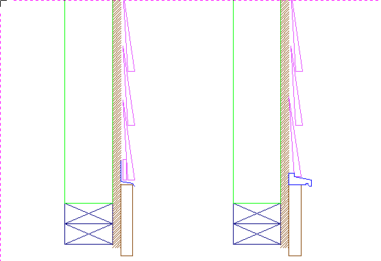

Combination of the two. Flashing under the drip cap, tucked under the housewrap/tar paper. Bed the DC in polurethane caulk if flashing isn't feasible/possible.
curious about why under the wood drip? We run metal over the wood drip always keeping drips running down. Placing it under would trap water on bottom of the drip should it get past the siding.

for a computer illiterate like me
are those fine illustrations you presented drawn by you "freehand" or drawn from a bank of architectural drawings or what?
a short primer please
you and framer among others have that down and I really appreciate it /I have aspirations to respond like that someday
cheers John
Those are drawn from my CAD program, using the most rudimetary drawing tools that would be available in even an inexpensive one. We had a similar discussion once before and I had sketched those out and remembered I had them. I think one is a copy of the other with an added version for purposes of that thread. Sometimes when we are analysing a problem or question somebody has, and the terminology is iffy or ponderous and confusing, it is easier to make a quick drawing and say, "Like this?" or to find a photo

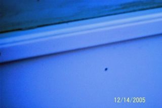

Oops. A perfect case of, 'do as I do, not as I say'. The photo shows the 5/4 PVC drip cap over Azek skirt with flashing ABOVE the cap, as you suggest, on a Victorian in Mystic that we are in the process of replacing all of the front facing lower trim. Mental lapse, my apologies to all who were misguided by my very wrong statement. "I am the master of my fate, I am the captain of my soul." Invictus, by Henley.
I`ve always used a combination of the two picture in your second pic.
Aluminum flashing over the drip cap. I typically instal undercourse shakes at this point to ensure the siding truly laps the back edge of the drip cap.
