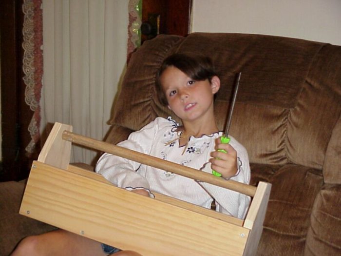

My little buddy was over at the house a while back, and she asked me if I would help her make a toolbox. We threw one together from some scrap lumber and a piece of an old broom handle.
Then my Son and I dug up some of our old tools and threw a few things in it for her. She seemed happy as a clam. And I think that would make a great project for any kid. It would certainly last longer than a birdhouse.

It looks great. Gotta admit mine doesn't look as good, technically speaking, but to me it's the best I'll ever own.

I don't think that toolbox was any great prize. And the tools we put in there for her were cheap ones and stuff we don't really use.
But to me the only project that's really wrong for a kid is the one that never gets done.
She may never be a tool wiz. But hopefully she'll remember that I spent time with her and helped he make it.
Last time I was over at her house she brought out a doll bed that she'd made with her tools. It was pretty pathetic, as doll beds go - Made from some weathered scraps of plywood. But she learned something from hammering that thing together. So I think I did the right thing.A third grade teacher was getting to know her pupils on the first day of school. She turned to one little girl and asked, "What does your Daddy do?" The girl replied, "Whatever my Mommy tells him to do."
