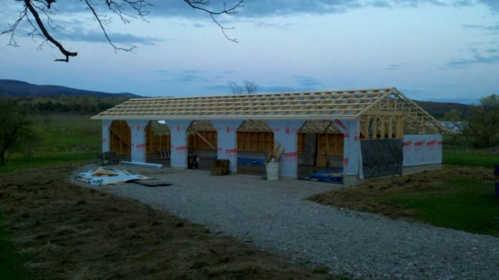

      Picture of trusses
      Here is a picture of the building under construction.  In the end, it almost looks like a chicken coop or low carriage barn.  If you can see, the ceiling inside slopes down considerably in the back 1/2 of the structure.  I'm not sure that can work for blown-in, other than filling it up completely, with baffles to hold it away from the roof.

        It looks like you're going to have a metal roof, judging by the purlins. Hopefully you're going to put nicely layered roofing felt down first, otherwise I would be concerned about condensation dripping from the bottom of the metal and getting the insulation and drywall wet.
        Anyway, you could baffle between the trusses and then blow in insulation. It would fill the space near the eaves and there would be some airspace near the ridge. Or, you could go with some or all of it as rigid board under the trusses.
        With large overhead doors, I think you're going to have a lot of air leakage, which will be your main problem in keeping the space warm.

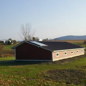

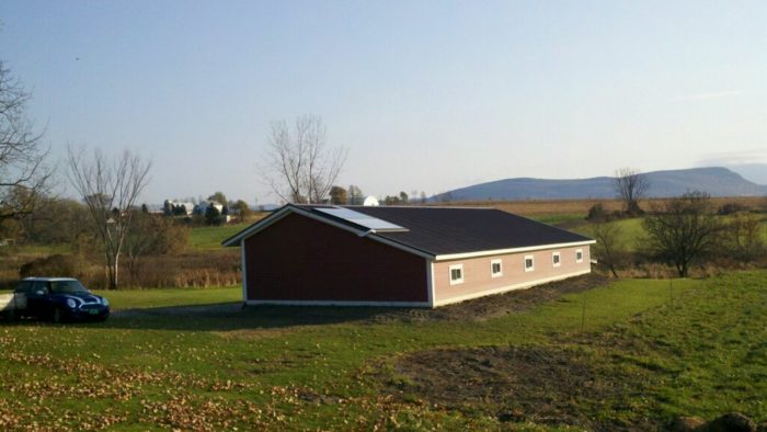

      Attached is the picture of the almost-finished project.
