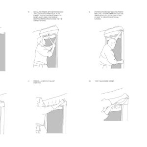

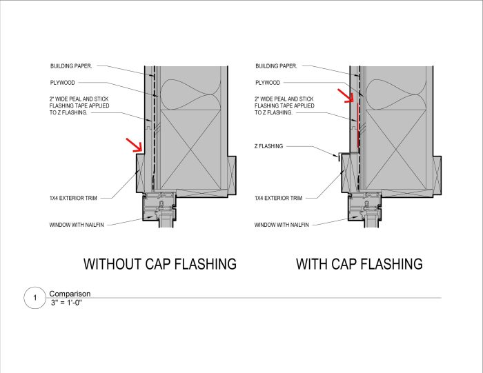

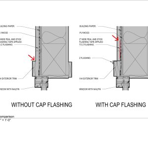

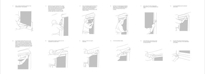

The AAMA (American Architectural Manufacturers Association) has a good “Standards Practice for Installation of Windows with a Mounting Flange in a Wood-Frame Construction Using Exterior Barrier Methods.” As far as I can tell, most window manufacturers’ installation recommendations are derived from this. As an architect, I often start my window details by reviewing this approach.
On the other hand, many nailfin windows in California (where I practice) are trimmed with 1×4 casing and this can be hard to coordinate with the AAMA installation methods. The application of head trim is a natural place for water to “catch” and enter the area between the trim and the siding. A good place for rot to start.
Is it a better pratice to put a piece of Z flashing above the header trim or am I overthinking this? It is hard to do this while adhering to the AAMA’s recommendations. I’ve attached a couple of images below to illustrate my conundrum. The “Flashing Sequence” attachment is an excerpt from my typical waterproofing instructions for windows. The “Window Detail Comparison” shows a lefthand detail I have found to be quite common in the construction industry despite the “reverse singling” of the head trim with the siding (see red arrow).
When a window is installed tight to an eave, it is probably overkill to install head flashing, but this eave may be absent on many more modern projects. The right-hand detail is one way to avoid water infiltration at the head condition, but it requires a build-out for the head trim. Even though the condition is less problematic, it still has a reverse singling of the building paper with a 2″ piece of peel and stick (see red arrow). Nevertheless, the absence of a “shelf” at that location is probably an improvement in rot risk.
I’d love to address this better than I have been without creating some insanely complicated architectural detail that contractors will hate for its fussiness. Any help improving things is appreciated.
Mike

    As an architect practicing in California, I often reference the AAMA’s “Standard Practice for Installation of Windows with a Mounting Flange in a Wood-Frame Construction Using Exterior Barrier Methods” when developing window details. While this provides a solid waterproofing foundation, adapting it to real-world conditions—especially with the widespread use of 1×4 trim casing—often introduces practical challenges.
    One recurring concern is water infiltration at the head casing, especially in designs without generous eaves. Trim at the head acts as a shelf, allowing water to collect and potentially seep behind the siding, creating an ideal condition for rot. In this context, the use of Z-flashing above the head trim is not overthinking—it’s a best practice. Despite the difficulty of integrating it neatly with AAMA sequences, especially where reverse shingling or peel-and-stick patchwork occurs, it provides essential redundancy against water intrusion.
    I’ve observed that windows set tight under eaves sometimes omit head flashing, but this feels short-sighted. Building conditions change, and eaves don’t always offer reliable long-term protection. The right-hand detail in my comparison—while bulkier—reduces the risk significantly by eliminating the shelf at the head and improving drainage. Even though it still shows some reverse shingling of the WRB, it’s a better-performing solution—much like how menu Greggs wraps
    https://greggsmenusprice.co.uk/ and presents items to ensure quality and consistency over time.
    Ultimately, the goal is to find the right balance between durability, design simplicity, and contractor execution. Clean, build-out trim with integrated Z-flashing may be the most realistic and effective compromise. I welcome further thoughts from others on improving this detail without overcomplicating the construction sequence.
