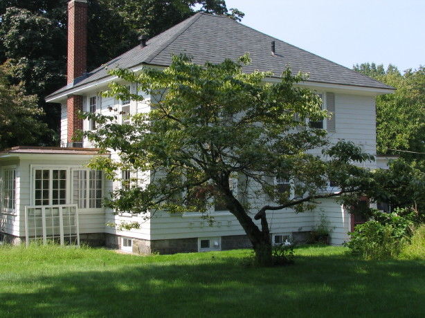

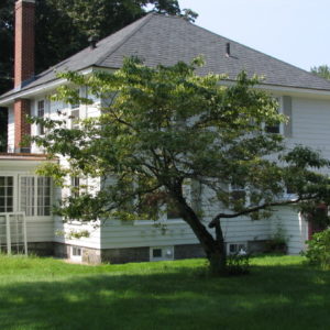

            I have attached a picture of the house from the rear to show the sunroom I mentioned. One of the storm windows is off. (I'm planning to replace the old windows with Marvin double-glazed casements. Its roof is copper-flashed with a rubber top surface.

          If any more pictures of the house (inside or out ) would help, please advise.
