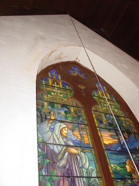

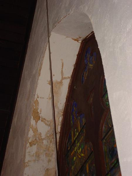

I went to a Church today with bad leakage around this Tiffany window.
Stone building with slate roof.
Shutterfly album attached for anyone willing to help.

It's weeping through the stone and/or mortar.

Looks to me like effloresence of the mortar wall. Usually caused by rain blowing against the wall itself. ( Looks like a small or no overhang). U could put a thin coat of elastomeric plaster over it to help seal it. Something like Total Wall or Accrocrete, Dryvit, STO etc.
The brick arch is getting saturated during extreme rains is my guess. 1st thing I'd try is sealing the brick. In fact, I don't see any other choices short of flashing all the way thru the wall under the arch over the window. Tough nut to crack.

They called me in thinking they had roof problems , but it soon was my thinking as well that it was coming thru the arch.
My initial suggestion was to cut out mortar and repoint that wall and then seal it well.
Thanks everyone for the help in confirming that it's most likely mortar related.
It's a National Register property so changing the front isn't an option.
Walter
I think I'd want to look at that bell ringer and how it's flashed in with the lead. There must be an opening of some type there. I'd also want to see the step flashing under the shingles. It's possible there is a crack. I doubt that it's just absorption through mortar. There is too much going on around that peak. Somebody tried to seal things up on the step flashing, obviously to no avail. There is a hole up there someplace and the ringer cap looks the most suspicious.Beat it to fit / Paint it to match
