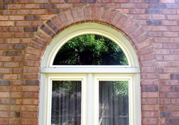

half round window trim vinyl siding
we just use flex-j around half round windows and then cover them with an aluminum cap matching the other window trim. The web has places you can purchase an aluminum half round window cap for vinyl siding if your contractor does not wish to make one
Do you know of a good source for aluminum half round window caps. We just had siding put on the house and they used the flex-j around the half round windows. I really think it would look much better covered like you suggest. Thanks!
flex-j or rubber j-channel
The same concept of the aluminum half round window trim is used in place of flex-j for our installers. We flash the bottom of the wall area with a "L" notched about every inch to create the curvature and seal it off. Then we apply the siding or shake with no face on the flashing. This makes it more accuate for the arch angle. Then we apply a good bead of sealant under the "L" and apply a "Half Round Window Trim" piece to face out the wall. Depending on the size of the gable, the face trim may be 1" to 3 1/2" to keep the smooth appearance. We only use flex-J where it can be covered and hidden as it is white, usually dingy looking, and ugly.
