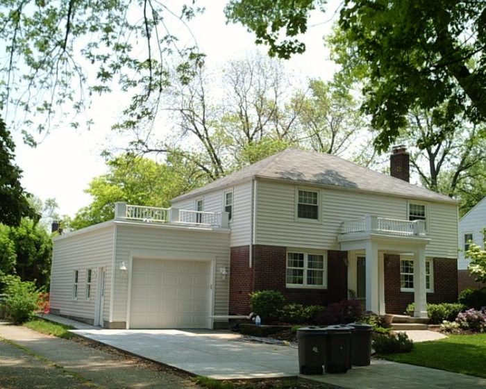

Ohh yeah....that's attractive....lol. I hope that window being blocked by the oversized railing post isn't the egress out of a bedroom.
The downspout spilling onto the driveway from 2' above should be a nice water feature- especially when the temps dip below freezing and create an iceskating rink. Of course, that's assuming that the lady of the house doesn't tear it off the house the first time she backs her SUV out of the garage.....
"The downspout spilling onto the driveway from 2' above should be a nice water feature"LOL!!That's the "automatic" wheel washer feature!Here is the resized pic.Rich BeckmanAnother day, another tool.
If you look closely, that downspout appears to have been disconnected halfway up the side of the house, and it flopped over above the driveway. If they hook it back up again, it will dump out in the shrubs next to the house.
If they hook it up again, and dump it in the bushes, they have a nice flow of water down the overdig there and, sooner or later, some nice puddles in the basement at that corner.(Of course, that's what they have now, but at least they wash the bricks AND know if they're too close to the right side of the garage when coming home Friday night from the Men's Grill.)
Particularly the neat way the distinct lack of slope seems to make flooding the garage seem as likely as an ice rink.
That "wing" off the driveway is neat, too. Not fairing a curve back into the driveway will mean some luverly ruts--and busted concrete--the next time the in-law's motorhome gets parked there.Occupational hazard of my occupation not being around (sorry Bubba)

Very um, interesting... I don't think we'll see this one on the cover of FHB or Archtectural Digest.
We live in a guilded age of form over substance.

They should have pulled there head out before theythought of that one.Probably said..."looks good from my house"
If I had to guess, that was a sub who was too stupid to stop and restart the gutter at the windows, and a GC and owner who didn'y notice. I'd be shocked if the architect had actually drawn it that way, but even if they did, it's a complete failure on the builder's part not to have corrected the error in the drawings and installed it correctly.
Shame on all those involved.
laughing my a$$ off at the gutter picture. Thats great! Made my day
KInd of makes sense, tho. Doesn't bissle up the exterior with several downpipes. They are, after all sash windows and the gutter is at the midpoint - no-one will see or bash their head. Standard practise in some of the 200-600 y/o houses I grew up around.ciao for niao

Sweet merciful crap....these are some of the worst blunders I've ever seen....

Besides the beautiful siding job on the side of the garage and the magnificient gutter work that's one poor widow's walk railing install. Besides the obvious running it into a window (hope their kid never has to bail out due to a fire) it should run into pilasters against the wall, it's what they were invented for... I'm guessing the roof slopes back against the house too right?

I'd venture that the dormers are those fake ones with the windows painted black inside, but I think I see interior space.......
That crete pad looks new. I think i would have tried to take advantage of having the concrete up to run the gutter drain under it and away.

Yup. the pad's new....guess he spent too much on his custom handmade cabs to sink some schedule 40 before the pour....
Where are the shutters? It's missing the cheesy vinyl shutters.
Ya know, you're absolutely right....did I mention that the flat roof of the portico doen't have gutters?
No, you didn't.
I did not see any scuppers on the two sides shown, so I was a bit loathe to zoom in to see if there's any evidence of slope at all on the roof.
Hmm, is that a DIY flat roof, I'm wondering? Little details that are easy to miss, like having the right u/l, cant strips, flashing, that sort of thing.
Just the sort of detail that a couple feet of winter snow will take advatange of . . .
Cinci, right? Get one of those wierd snow then rain then freeze events. Snow finds (or lifts) a bad/poor spot on the roof membrane. The rain then washes the snow into the garage through the roof, and then runs out the bad d/s to then freeze. Might look like that "bad winter" picture of the cars iced into the garage.Occupational hazard of my occupation not being around (sorry Bubba)
Buffalo....not a DIY job, but sometimes I think the majority of "pros" around here might as well be DIYers...they side, wrap & caulk anything & everything up here & think it's fine homebuilding...

Yeow, even worse, that's lake-effect snow & blizzards & the like.
Will be bad if the newel-blocked window is the only one they can dig out through . . . Occupational hazard of my occupation not being around (sorry Bubba)
I wonder what sort of support would be required for a flat roof in Buffalo (or anywhere with significant snow loads). I'm suprised that a flat roof meets code there...
I'm guessing you dont get to pick from the 20# load tables . . . <g>
Might be tricky, getting the drip holes in the roof just right to make icicle "lally columns" to support a snow load . . .
Wait, maybe we're just 'assuming' it's a garage from the door--what if it's actually a pool/ice rink combo? That would explain the flat roof and d/s . . .
