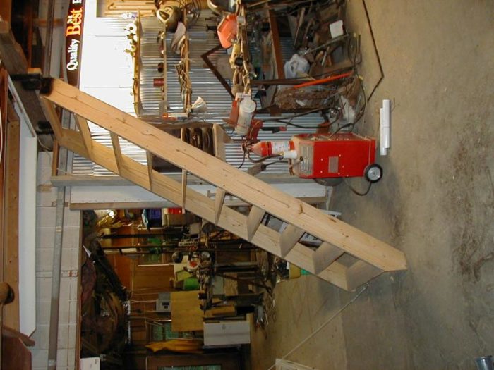

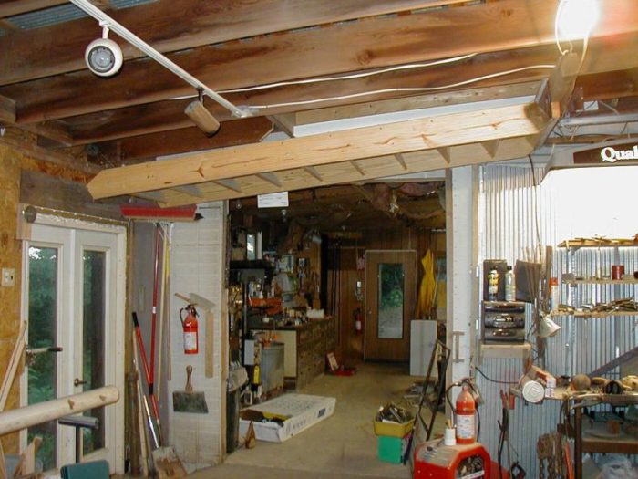

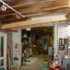

  2. IronHelix | Jun 09, 2003 02:15pm | #2
    Had an occassion to do a little work in a local bank and they had an attic stairs that was awesome....I imagine the price was also.
    It was set of aluminum steps and carriages that slid on the hatchway up into the attic until it reached a balance point at which the whole assembly and hatch folded into the ceiling. The attic was at least 10 ft in height and the steps were aligned with the length.  There were at least 6 trusses that had been engineered to allow the step assembly to cut across.  The whole assemble was raised and lowered by motor.
    Been too-o-o-o-o long ago to remember the brand name.
    On a lesser note, I have built a crank up set of stairs into my shop attic.  I'll try a pic!
    ....................Iron Helix
    1. spectrumfirs | Jun 11, 2003 01:01am | #6
      I just checked with Bessler about the attic stairs and the lead time did not work out.  I showed the client the photos you emailed over, and the were quite intrigued.  I am now planning on trying something similar for them.  Basically I am going to use a block and tackle principle for the pulleys, any other suggestions or advice?
