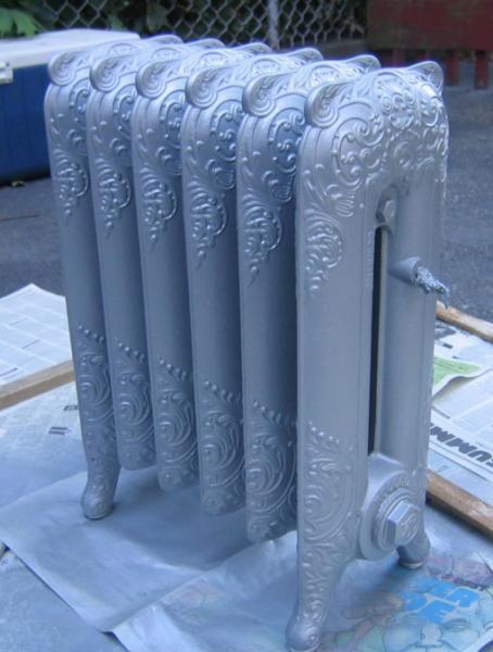

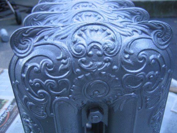

sandblast clean, 2 thin coats of primer, 3 coats of hammered finish.
looks sharp, nice clear lines.
American Radiator Co. - Rococosplat
Vrey sharp indeed! I had that style radiators in my first house, but current ones have just plain tubes. Since the house is a very plain 1695 farmhouse, the radiators are more appropriate, but yours are prettier!
