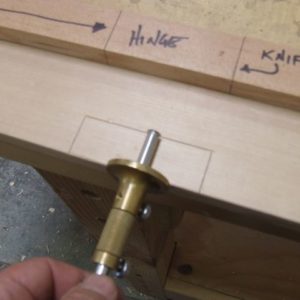

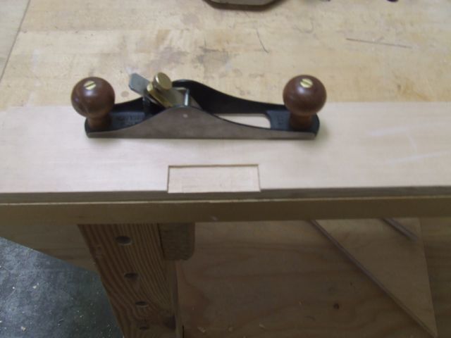

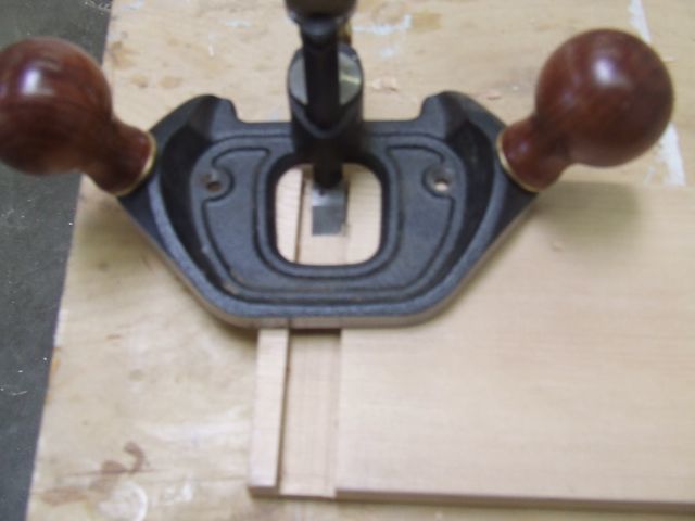

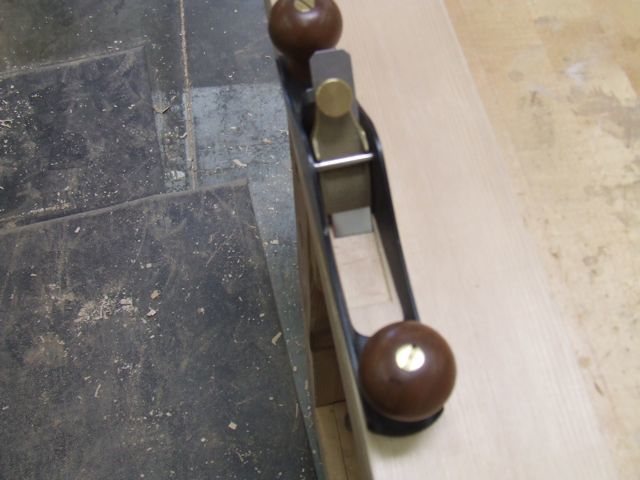

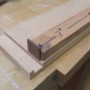

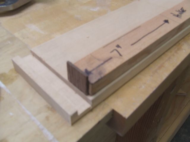

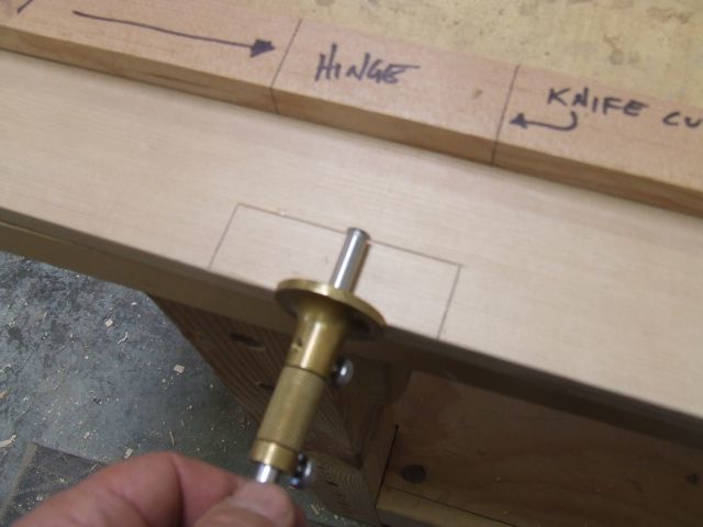

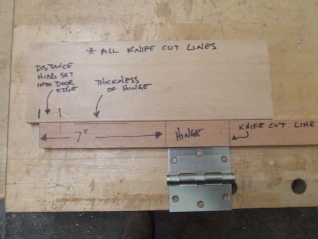

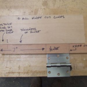

One of the things I do to insure that the hinges line up is to use a story pole.
Using a piece of scrap the height of the door mark out hinge placement, then at the top of the story pole glue on a piece of material the such that the thickness is the same as the reveal when hung. Have this piece of scrap overhang on a couple of sides.
Hook the pole over the top of the door to mark out the doors and but up against the jamb header when marking out the jamb. This will automatically give the correct gap at the header

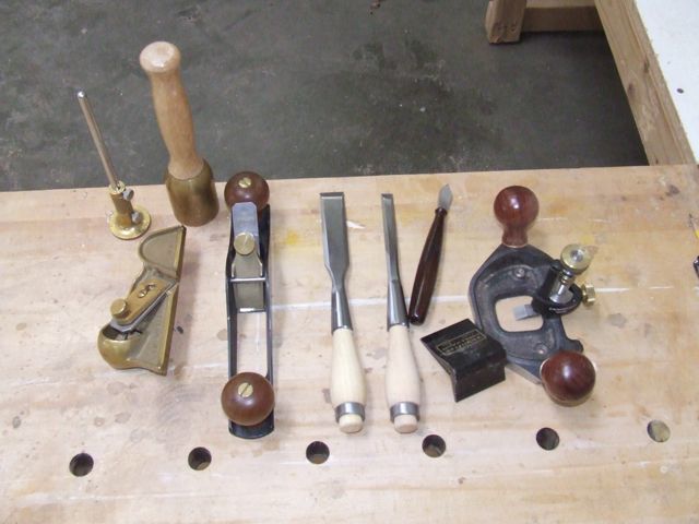

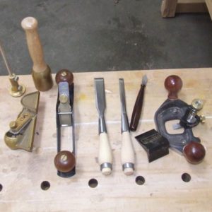

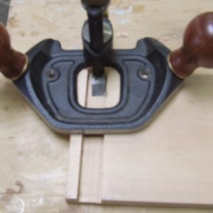

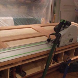

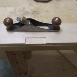

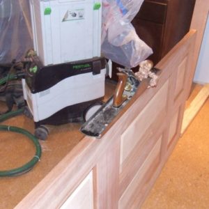

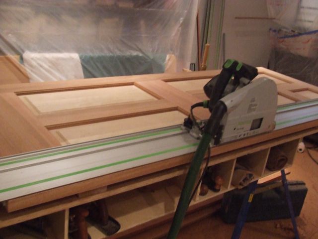

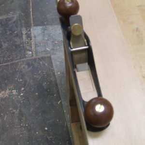

attached are some pics and a sketchup drawing.

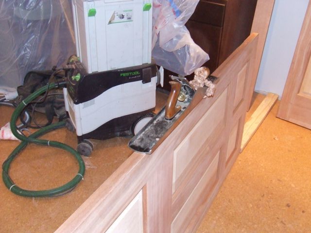

The more narrow the door the greater the need for a bevel. Wether you use a saw or a power plane it is nice to remove the tool marks before finish is applied with hand plane. Generally one pass will do the job.
Whoever said it is right - a picture is worth a thousand words. Thanks for the pointers and I certainly appreciate the photos. Many years ago I remember an older uncle of mine using story poles for everything (he was a finish carpenter in NYC). I never thought of using one for the jamb/door unit. Thank you and P.S. Does the material used for the stop need to be anything specific?
Frosty,I use anything handy for the reveal gap spacer. These tend to be throw away items.
