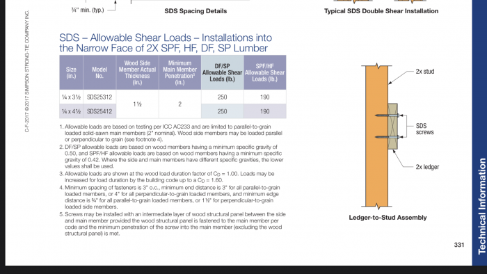

    You’ll need to confirm w/ your building inspector, but I’ve been able to do a ledger to stud connection using Simpson SDS screws. In general, I’ve found that if inspectors see the Simpson label they are more likely to approve the connection. I’ve attached info that Simpson provides for ledger attachment. The inspector will most likely make sure you followed Simpson’s requirements. Simpson has a solution for just about every wood connection you can imagine. Check their online sources for guidance.

    How would you install the tension ties to studs? Might not be a practical issue with a 4 ft. deep deck, but if your inspector is a stickler it could be an issue.

    I was confused by your wording, I apologize. I thought you were asking how to attach deck higher than location of interior rim joist (assumed you were calling interior rim joist a ledger as well). Are you asking how to make a multi-level deck? Maybe a quick drawing would help?
