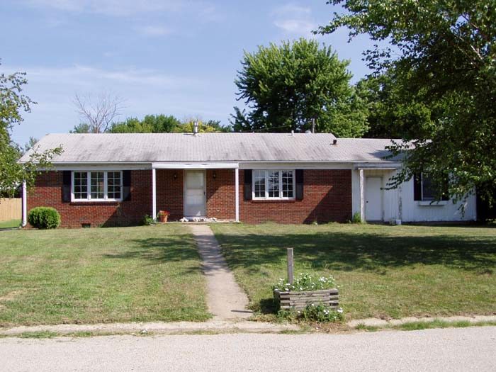

Talk about bland rooflines. Suggestions on improving the roof appearance?
Obviously it needs new shingles, but I have also been thinking of:
1. tearing the roof off the garage and creating a cross gable there
2. putting a gable in for the front porch
3. increasing the overhangs & rakes
Another option might just be to have someone come in and tear off the old roof and put a new one on.
New furnace is going in a different location, so that ugly vent is going bye-bye. The rusty stove vent is probably also going. The front door & roof on the garage is also going (who puts TWO front doors on their house and no BACK door?!). One of my motivations for cross gabling the garage is the possibilty of adding on to the back of it some time in the future (and go from a rectangular house shape to “L” shape).
A friend suggested putting a wider porch across the front and just making a wide gabled roof for it. Possible, but there is a sewer cleanout just to the right of the middle window unit.
Ideas?

Why spend the money adding gables unless you're also adding useful interior spaces? The only exception for me would be the front stoop.
Instead, re-roof using a high-grade architectural shingle, and plant a couple more ingteresting-looking trees.
Unless you're the lead dog, the view just never changes.
whata wrong with it now ? There aint no blue tarps on it or nothin
what about going with dark greyish shingles^^^^^^
S N A F U (Situation Normal: All Fouled Up)
I'm with YesMaam27577 - Do something with the front porch, leave the rest alone.
the roof is what it is
i would look at a new porch. It's centered on the facade, do it up. Same with that little entry near the garage. Keep that one small, but treat it in a similar way (don't copy). Start an interesting dialogue between them.
Landscaping and a new walkway would help too.

So in your opinion, less grief to change the garage gable and put a porch gable on... and extend the overhangs a bit, rather than just rip the whole mutha off and slap trusses on?

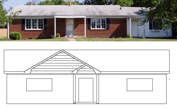

See attached. I did not spend too much time and it is not to scale, but is a suggestion that woudl take away form the plain jane look. It adds more (and I think the house needs more) than a gable over the Porch.

Easier for me to picture 'em side by side (so to speak).
Edited 8/25/2006 6:16 pm by JohnT8
can you draw in a front porch railing^^^^^^
John,
Looks nice, but one concern. on the left
where the gable ends maybe make a little wider
so it doesn't bear over the window and allow
room for a nice column without obstructing
the view... Just a thought. But it sure does dress it up
and add a nice outside seating area.....
Mclaren
I like your rendering better than my 2D. The house does need some off symmetry (DBL gable) to help the looks. Landscaping would be a big help.
Your pic got me thinking about extending the porch over. Even with that pic I'd saved, I hadn't really considered that. Whichever method I go with, I want to maximize the bang for the buck.
So the two alternatives along those lines:
1. Rip out current porch, remove concrete slab there 2. put a new porch slab in extending the new porch to around the left edge of the left window. 3. Put a roof over it. 4. put rail in
or
1. Rip out the current porch 2. excavate & put in a foundation for an entry. 3. enclose the entry, etc,etc, etc. 15. Put a roof over it.
Option #2 has a lot more finishing required, but a smaller footprint. I'm not sure which one would be cheaper.
