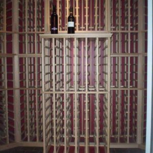

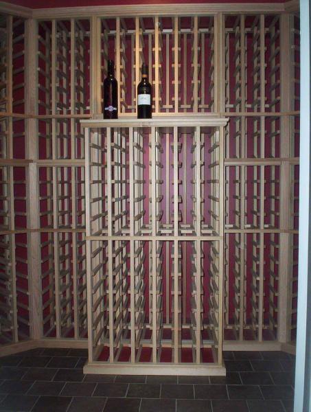

Use it in wine cellars. Routs pretty well, smells great BUT dust control is a must if you like your lungs.
