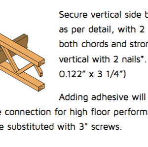

    For the vibration issue, you can simply add strongback ! They are cheap and they can virtually eliminate vibration as they tie the floor together, giving it strength and stability. ;) See the image below and we also have a blog post on that topic : http://www.openjoisttriforce.com/cantilevers-best-practices-with-open-joist-construction/
