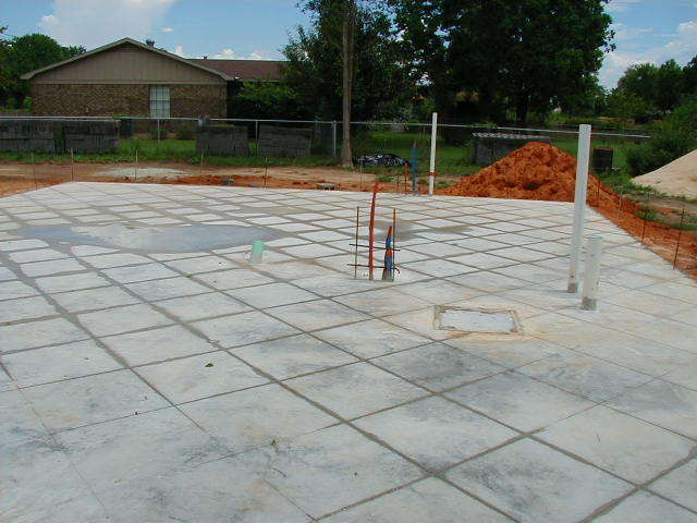

planning new construction in coastal NC, using slab floor, want to use color to avoid grey. anyone tried the etching stains? sure looks cool. how long to cure concrete before application? Scofield rep says two weeks, longer is better. don’t get pissy and sour on this idea just b/c you’ve never tried it. who has had interesting results?
Check out http://www.acid-stain.com I have tried it....yet

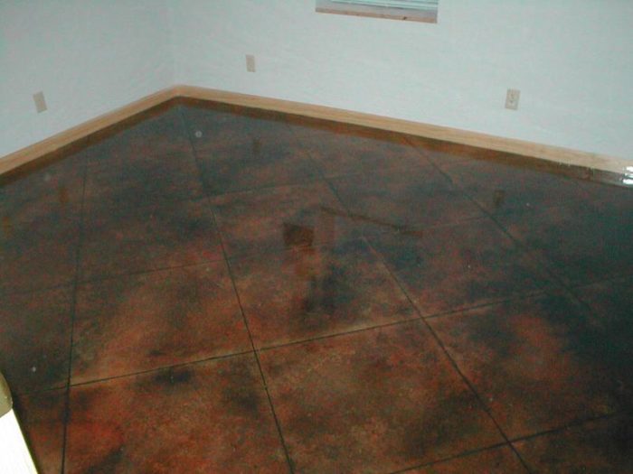

sooner you get the stain on the deeper the colors and less chance of something spot'n up... if you want really good colors... i dust the wet concrete with white portland... thats opional... it's easy to do... easy to score & lay out... look at a few pics i just posted in the photos... that was a 30 cut job... maybe 2hrs on the stain but i was play'n alot... I skip the sealers and go to a commerical floor wax... & buff... guys who do it for a living will try to make you think there is voodoo involved... there isn't... anything you screw up is just "character" and you can restain if you don't like the look u get as long as u do it before you seal.... worste case you have a stained slab under your finished floor :)

look in the photo section... scroll thru the pics i posted... u'll see em...
and yes i think the concrete should be stained and at least one coat of sealer put on before any trade gets in the building... u just have to watch the people who want to hammer on your concrete...

it's under a post i made maybe 5 down... "a few more loft pics" 2 are of a first floor i cut/scored a star into and stained and one i think is of a second floor (12000 sf) that poured and stained & sealed before it was framed...

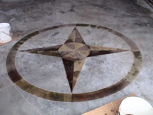

I just did my first floor - turned out great. Bought a sample kit and masked out a fairly cool compass on the floor (ala the 'our cool house') All the local concrete supply houses in Duluth, mn had some type. Concrete Depot on line is where I got the sample kit.effect was obtained by brushing with stain.
