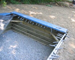

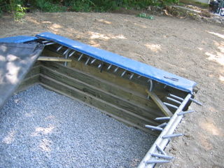

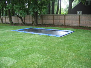

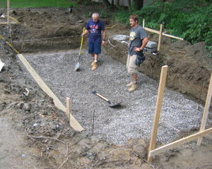

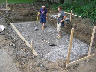

      2. ovolo | Aug 25, 2006 11:35pm | #21
        For the record. Here is how we did it. It works and they are happy. (hopefully my pics come thru)http://www.thesmallbuildingcompany.com
