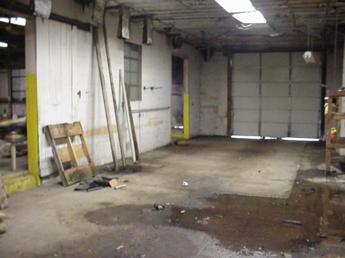

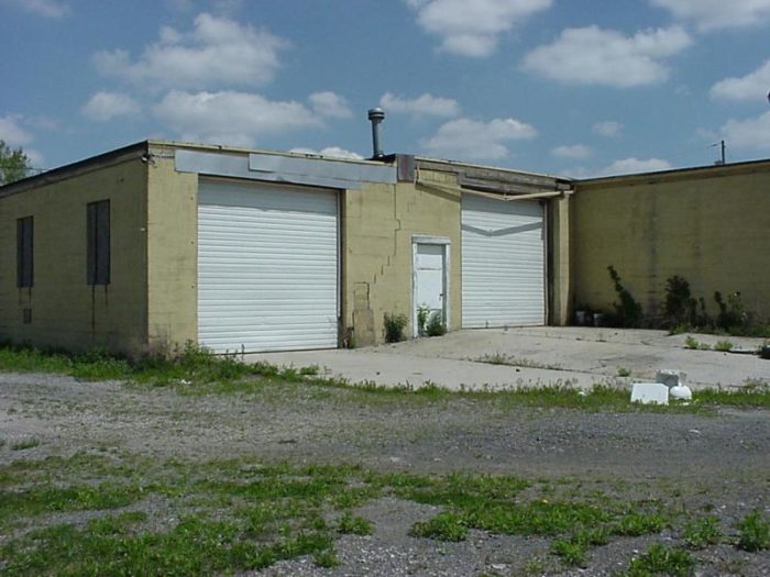

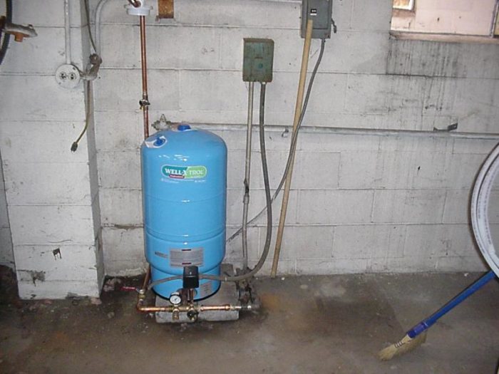

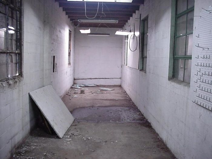

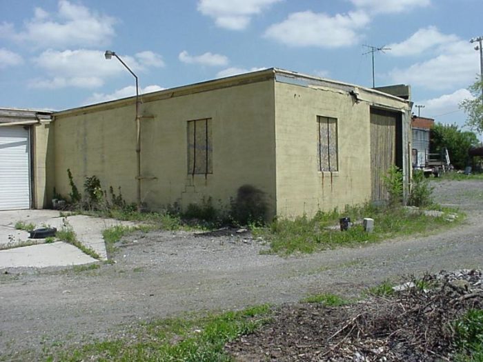

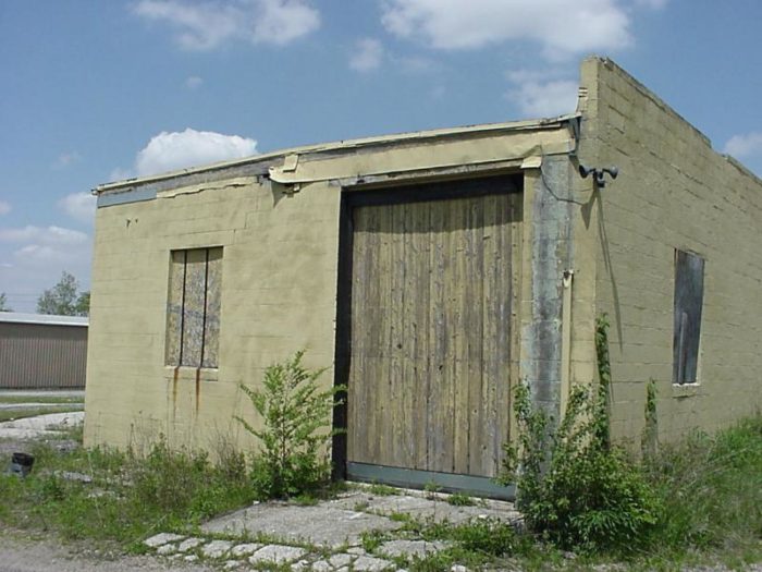

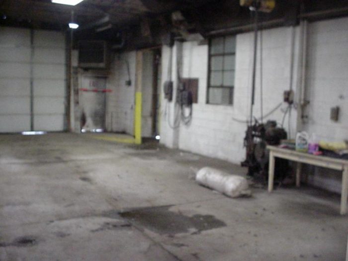

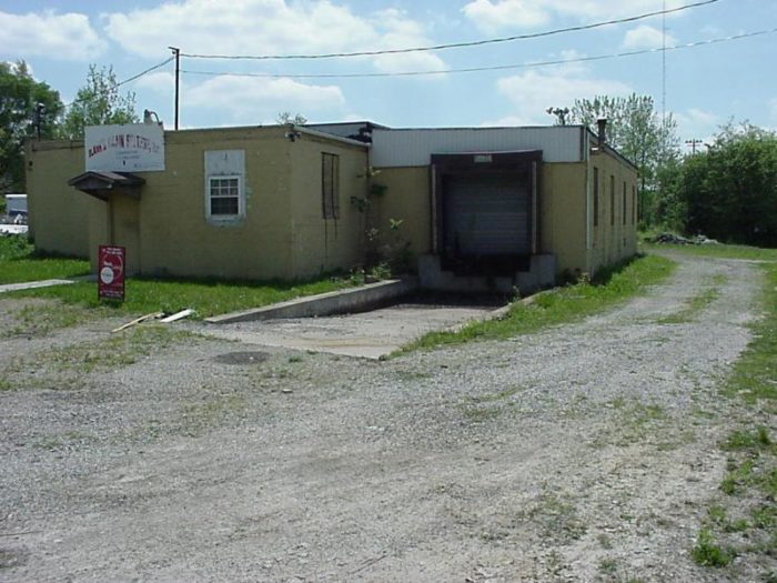

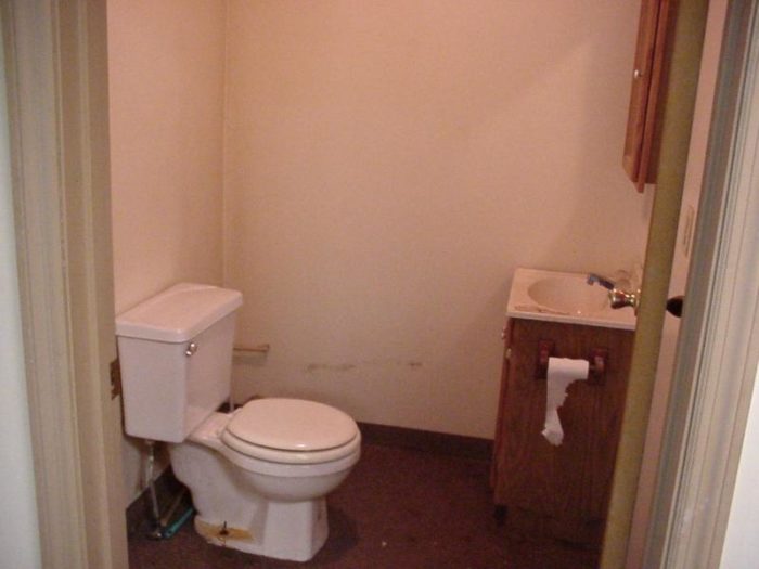

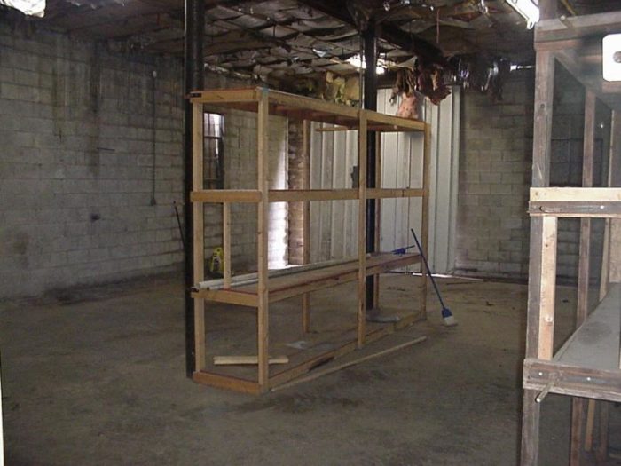

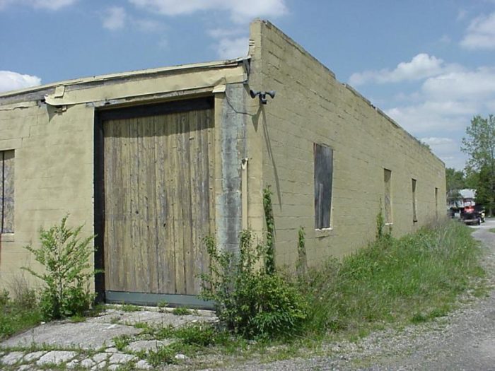

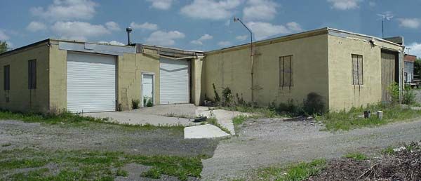

Here are the pictures of my new shop. I said it needed work. The well pump tank is new. I got it done before I took the pictures. The copier came with the place because it only made dark copies. Looked it over and cleaned the lenses and reflectors and bingo! Free nice copier. I love the little side deals. DanT

That loading dock is a big plus.
Mike
Sure is,we get a few truck deliveries and have to pay an extra $50 for a lift gate so it is an actual money saver. DanT

Dan, that is one butt ugly building....
and I like it - hope the shift/crack in the wall near the rear door is not a big deal -

I believe that is caused by a hole caused when someone hit the side of the door trying to drive in the door. Probably Gunner. He said he hasn't seen it but we all know he travels all the time.
But we will rebuild it somewhat as I am masonarialy (is that a word!?) handicap and then patch the cracks and paint. Which will look good in the end and maybe last a few years anyway lol. DanT

ooooh, cool... Lots of space, a loading dock, big rollup door, office space, indoor toilet..
Exterior... hmm, pressure washer and paint sprayer on exterior. New windows. Based on the water inside, I'm gonna guess roof work (and flashing). Crack between the rollup doors and ones under a window or two worries me a bit. Gotta a heck of a lotta doors on that building. Sure you need all those doors?! And if you're there after dark, I want better exterior lighting.
Interior... lots of pressure washer and paint sprayer here too. Probably some Kilz would be nice. Gonna fill a dumpster on this one. Don't know if I like that ceiling insulation, looks like its been wet. I'd be tempted to sacrifice 6"-12" of exterior wall and put up some insulation.

I have some plans for the outside. Fix the roof and block caps first. A false fascia of steel siding next. Front to get steel siding top to bottom. Block sides get paint. No windows. I don't do windows in buildings with tools. Just add more lighting.
The inside insulation was just hung up there and over time has simply fallen down. Some has been wet and now some is missing. We have always held it up with chicken wire stapled to the joists. So that is the plan along with refreshing the missing.
We had planned to paint the interior but it is pretty white now, just needs cleaned so yes to the pressure washer. The offices, bathroom, breakroom areas all get paint, carpet in Gunners office. He hasn't said the color yet.

What kind of neighborhood is this thing in? Got a lot of break-ins in the area? Tell DW to start looking for a new project house, cuz you don't need that building out back any more!
So what are you going to do with the window openings? As attractive as that OSB is... Going to just block the openings and try to blend them into the wall when you paint?
Kinda tough to have a warehouse without natural light or ventilation other than the roll-ups. The new high school near my project house has some of those fixed, translucent panels in place of some windows. I am completely blanking out on who makes them.. IIRC there are at least two companies. They are fixed in place in the window openings and still give you some natural light. If you weren't going to insulate the ceiling, I would have suggested skylites. Otherwise the always popular windows with bars. But I sure understand not wanting to give the thieves any easy way in.
In cases where you pull it, do you dumpster or truck it? My current project has seen me removing a record amount of insulation (for me). I find it very frustrating how much dumpster space insulation takes up. The only strategy I have for it is to put it in first and let it get rained on and put heavy stuff on top of it. Not a very effective strategy based on what dumpsters cost.
Metal joists? Shame you couldn't use Mike Smith's trick with the mesh fabric and blown-in insulation. Don't know how you could with metal joists though. Chicken wire can always be wired to metal joists, but Mike's mesh stuff probably wouldn't wire well.
White is great for making rooms lighter, but it sure shows every grimy fingerprint. I always wondered if those old '70's paint schemes that had the lower 5-6' of the warehouse wall painted a darker color were on to something.

this building has great bones.... good paint job and sweeping,little landscape and some exterior lighting jeezus now you have a tax problem. stinky
How close to the ballfields? If it's -Base-ball, might need to factor in replacement glass for your Windows budget...
