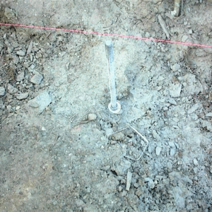

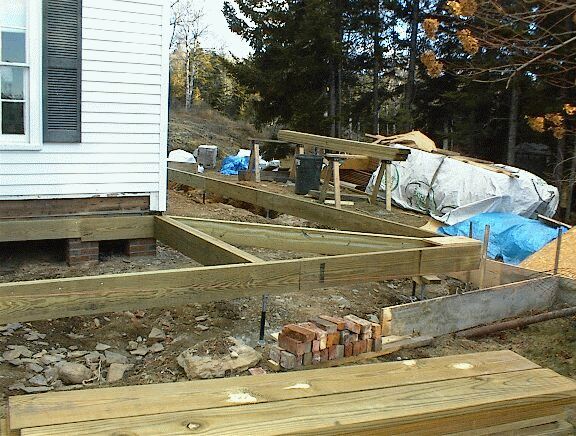

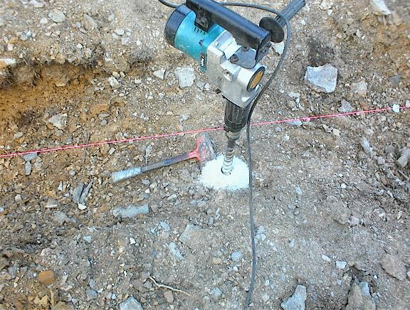

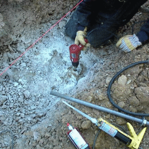

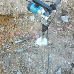

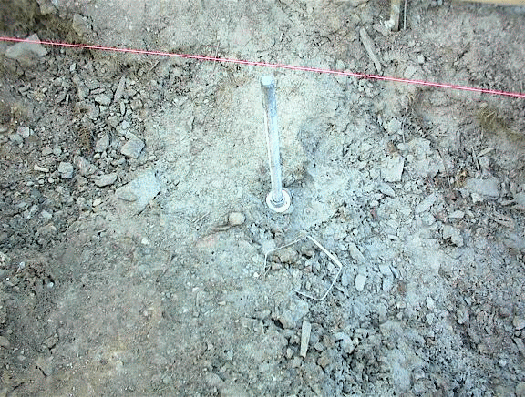

  6. Piffin | Apr 16, 2008 04:56am | #10

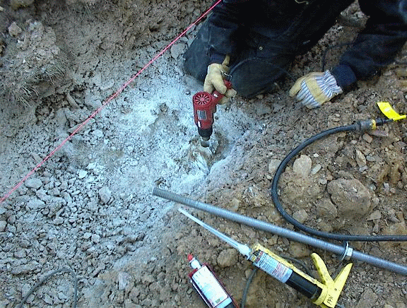

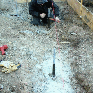

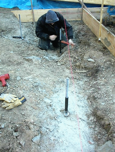

    I build over ledge a lot. Drill a 1" hole 8" deep in the rock and set 3/4" allthread in masonry epoxy from Simpson. Then large heavy washers and double nuts to support 4x4s with a 3/4" hole drilled in the bottom. The nuts let you adjust the elevation a bit.
    1. Piffin | Apr 16, 2008 04:58am | #11
      Want some photos of your idea in action?
        Luka | Apr 16, 2008 05:08am | #12
        You bet ! You have some ?=0)
        Politics: the blind insulting the blind.
        1. Piffin | Apr 16, 2008 05:39am | #14
          All but the bracket saddle.I also sleeved the allthread ( on this it looks like it was full 1" bar" with ABS scrap so the frost would not be hooking the threads.

          2. fingersandtoes | Apr 17, 2008 08:05am | #17
            I've never seen that done. It's a good idea. The only thing wrong with it is it looks like it shouldn't be able to support the deck.
          3. Piffin | Apr 17, 2008 02:30pm | #18
            all the load is vertical. We have had four feet of wet snow and ice on that deck. We also had a staging tower set up on it of steel pipe staging for roofing and rebuilding a chimney. The masons had it loaded pretty good!
          4. fingersandtoes | Apr 17, 2008 06:01pm | #19
            Practically it's fine. I was more thinking of a past client who had delicate sensibilities (and was ummm... a good 300lbs!) Probably guided by legitimate instincts for self-preservation, she was very particular where she stepped. I can see having to put up dummy posts to sooth people like her's fears that it is too flimsy.
            I think it is a very elegant solution. Can't wait to find some more rock to build on.
