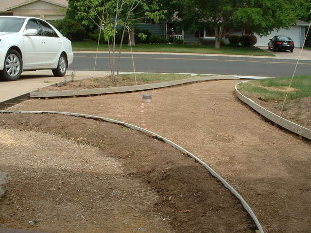

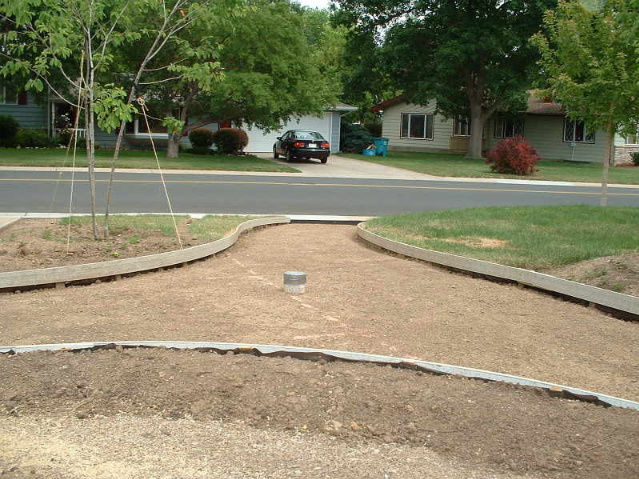

I like your pics ... going to be nice! Love the sweeping curves.

Nice clean prep work.
Looks good.
Thanks! Nice of you to notice and say so. When I can, I do things to the best of my ability.
This front yard is going to just shine.
