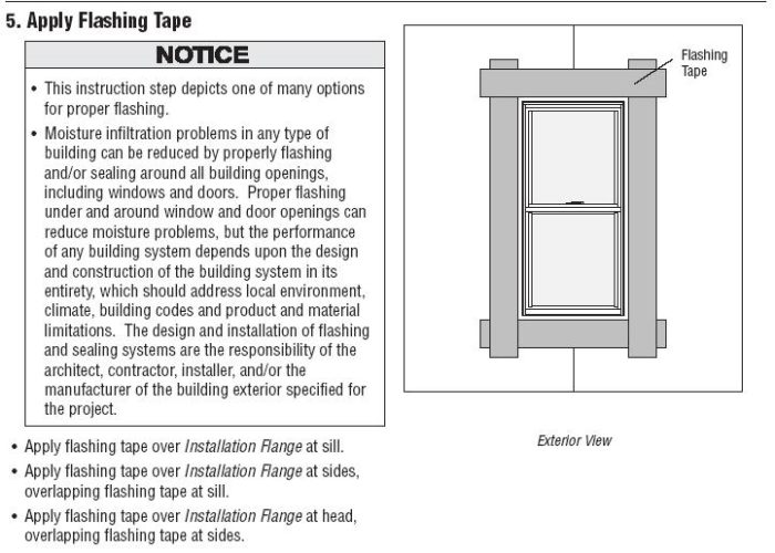

This is direct from the installation instructions on Andersen’s web site for their 200 series tilt-wash windows (it’s the same as the paper that came with the windows when they were delivered).
They have you flash the sill OVER the flange – I would have thought it would go under.  The rest makes sense.

    Read the first line " one of MANY' proper"..I do it that way on my installs here on my house, if a GC or a coustomer wants it different than what is called "proper" by the maunfacturer, we talk.

    The idea is to seal the flange against air leakage. Hopefully there's no way for water to get behind the sill flange, so taping over it should be OK.

    I just installed Anderson 400's on my house and they came with the same instructions.  I read 'em just for sh1ts and giggles and thought the same thing.  I made a 'pan' out of the Tyvek and then taped over the flanges as directed.  Figure that if I ever had a warranty issue, it would be best not to give them any ammo.  Also scanned the installation instructions onto the computer in case it ever became an issue.

          I pan the sill with strips of I&W, flash the jacks and headers with felt, install the windows (Andersens usually), AND then flash over the flanges (with vycor or strips of I&W).  Will also bring the housewrap down over the outermost layer of header flashing.  Think like a raindrop.

    Andersen is not the only window manufacturer that uses the same system as shown.
    The only thing which looks different from some other manufacturers is the top of the vertical tape / flashings are usually illustrated as being covered by the head jamb tape.  Taping order is usually bottom first, then both sides, top is last.
    Like some others have said - following the manufacturer's instructions / suggestions is always a good idea if there are ever any warranty issues.
