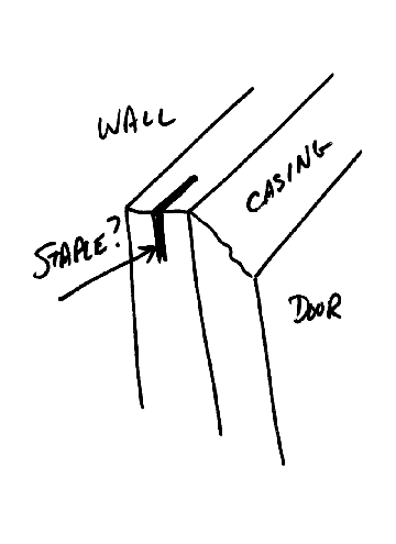

My house is about 10 years old.  About half the door casing miters are held tight with what looks like staples on the edge.  Do any of you use this technique?  Is there a special tool to place these staples?

    Special tool with a special fastner...
    I think you'll find that most here just use their pinners or brad nailers to counter edge nail to do the same job.. and a little glue in the joint...

    That's probably a cinch fastener (here's an example from Senco http://www.senco.com/pdf/catalog/n_clamp.pdf ), high-production trim crews sometimes use them, but they're very difficult to use without an exotic production environment (e.g. full clamping table/jigs).

    I'd guess it was a prehung door, which means the factory put that trim together.  And they probably use some $800,000 machine to do it.  Either that or some $6/hour guy with the Senco gun.

    For my casing, I've used a 1.5" brad nail nailed into the top and side to hold the casing tight.  I did that all thru the upstairs of my house.  This technique keeps the miters tight but not necessarily flush with each other...especially in my old house where all the walls are no longer flat.
    For the downstairs (which I'll be starting soon), I'm using a thick enough casing to use biscuits in the miters.  I figure that along with glue and fast setting glue should do the trick.  The second to last issue of FHB has an article on this.

    it's a prehung ....
    either one side applied casing .. or a split jamb.
    factory installed ...
    and they're crap (the fasteners ... not your doors) compared to a few well placed nails and actually putting some glue in there ....
    I wish they'd figure out a way to leave those little useless fasteners out ... about all they're good for is every now and then splitting the applied casing as ya lift the door into place ....
    or maybe if the factory would just buy a little bottle of yellow glue ...

    Like Jeff says, there crap. Glue and pin the corners, thats all you need.
