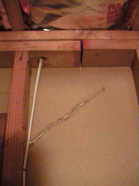

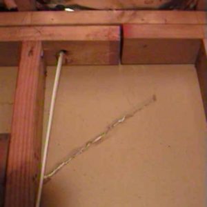

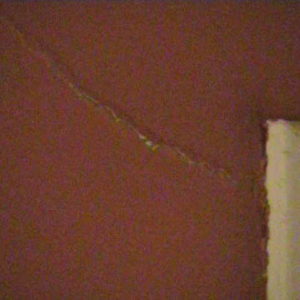

          1. Piffin | Jan 11, 2006 07:37am | #11
            That rock looks like it was brokenn before it was srewed in place to begin with.The top platres are not nailed together so that might amplify thingsUse six screws and run three up into each top plate each side of the butt.Cut the broken SR out so there is about a 3/8" gap. From the back side - in the wall, glue a scrap of plywood or 2x8 in place or even a 1x10 - something to span the gap and stabilixe the SR. You can run some SR screws into the SR on either side of the crack to the scrap behind.Use Durabond to fill gap and first coat, then finiishing compound to final it.
          2. FastEddie | Jan 11, 2006 08:05am | #12
            I had to read your suggestion 2-3 times to figger out what you meant in line 4.  Now I got it ... you mean widen the crack to about 3/8" and screw a splice across the back side of the crack.  Sounds like a good plan.  Have to wonder why they went ahead and instalkled a broken piece the first time.

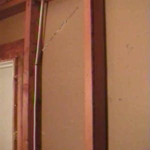

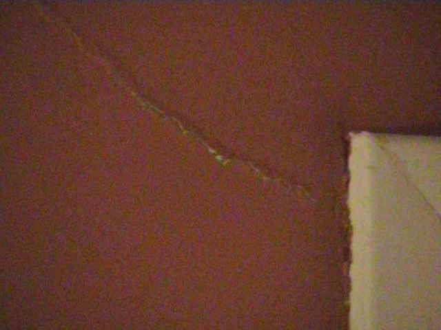

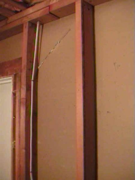

    3. dockelly | Jan 11, 2006 06:46am | #8
      hope this works. pictures of the problem.
      thanks
      kevin
      1. JTC1 | Jan 11, 2006 07:31am | #10
        My guess as to problem:
        The wall top plate is moving in relation to the top plate doubler when the door is opened and closed.  Since the door jamb is only fastened to the stud it moves the framing somewhat when opened / closed / slammed.  Since the top plate moves in relation to the top plate doubler the drywall eventually cracked at the diagonal break shown.
        My guess at solution:
        Refasten the two top plates to each other, add a butt / splice block below the existing top plate in the bay with the joint.
        Adding additional stud may help (probably can't hurt), but I think the real issue is the door framing moving in relation to the top plate doubler which is anchored to the joists above.
        Jim
