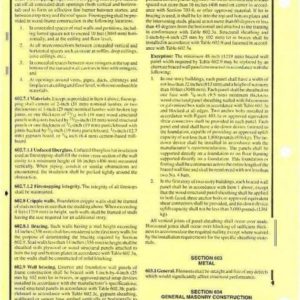

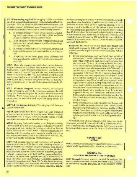

          3. dovetail97128 | Jul 10, 2008 05:23am | #17
            You guys got me curious so I went and dug out my old CABO code book.
            I have no copy of the newer code to reference. Here is a scan of the pertinent page from CABO.
