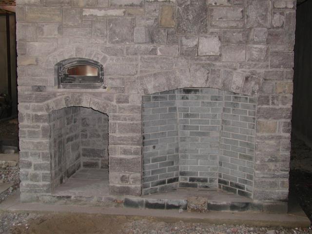

Here I used 4" stainless steel pipe, ran it into the basement and then to the outside.

Nice looking job. Two questions: How do you keep the ashes out of it? And, you been starting fires with WD-40?http://grantlogan.net/

that is one nice Rummer! Does it use a flue and throat kit from superior Clay? I have a five foot wide Rummer with 2 three inch freshair inlets which I put on the sides one fire brick up. each has a shutter. I have since found that proper combustion makeup would be closer to the area of the flue. Mine is 20x20. The fireplace works great, BUT, I haven't finished sealing up the building envelope, so I would say the jury is still out.
That's a beauty!
What sort of fire brick is that? I like how you matched the facing.
Some answers........I can't remember what that can of WD-40 was for for, but no........it wasn't for starting a fire. But.....for some of you more adventurous people, I'm sure it would work! And the spots on the hearth were from our boots walking around the wet jobsite.The grates I use are cast iron, and they have a sliding grate that opens and closes the air flow. It's not ideal, but quite frankly...I have'nt seen anything better on the market.With a Rumford fireplace, the fire should be placed as far back against the wall as can be, especially because they are shallow as it is. This will keep ash from going down the air vent.Still, it is something that you have to be cognizant about. What helps also is the air flow coming from the vent.The bricks are made from soapstone, ($10.00 per brick!) and the facing is granite that was picked out by the homeowners long before the decision to use soapstone brick. Originally we were going to use Morin Red Restoration brick in the fireplace, but after some research the homeowners decided on the soapstone.This was my second soapstone Rumford, the first is directly under the one in the picture, in the basement.On another note, to be honest.........I don't like the idea of fresh air supply. I especially don't like the idea of having the state tell me that it has to be there, but here in CT it is code........so, I only put it in because I have to. I know, I know..........fresh air supply to the fire reduces burning of preheated air, is more energy efficient........yada yada yada. I do mostly 18th Century repro fireplaces and because it's code I have to put them in.........and they look like ####.New houses, no big deal. But, I also don't believe they work. I finally rebuilt the fireplace in the house I've lived in for 12 years and as an experiment I installed a fresh air supply. All it did was turn the fireplace into a blast furnace........sucked up wood like there was no tomorrow.I think what some people have to realize is.........that a fireplace is just that........a fireplace. You cannot turn it into a heat producing furnace no matter what you do. And even though a Rumford is the most efficient way to build a fireplace.........in the end there's still heat loss. Typically you'd start a fire say........mid day on the weekends, or early evening during the week. Go to bed, you still have to leave the damper open because the fire hasn't burned out yet. Get up in the morning.......fire's out and your furnace heated air is going out the chimney. I know glass doors are an option, but if you're going to do that you might as well by a woodstove.A fireplace is................... a fireplace. Rod
Thanks for the reply. You make a mean fireplace! You didn't mention whether or not you used a kit or laid your own throat. Just curious as I have made a couple Rumfords myself and am interested in the throat tiles.
Oh yea ten buck's a brick ouch!!
I've done it both ways although I usually just build my own throats. The 2 times I've used the kit it's because the homeowner bought it and needed someone to put it together. I think he thought that it was a fool proof way to make sure that the draw of the fireplace worked. And it is. But it's tough to part with that kinda money when I can just build it myself. Plus.........you're committed to use their damper which is pricey too. I use "tip & slide" dampers.That being said...........it does save a lot of time........on a new fireplace. They aren't any good for retrofitting an older fireplace. Did that once, again, because the homeowner bought it and wanted to "make it work". It was more like, "make it fit", and would have been easier if I had just done it myself with brick & mortar, but the homeowner insisted. It works, but probably took twice as long to retrofit. But .......he's happy. Rod
