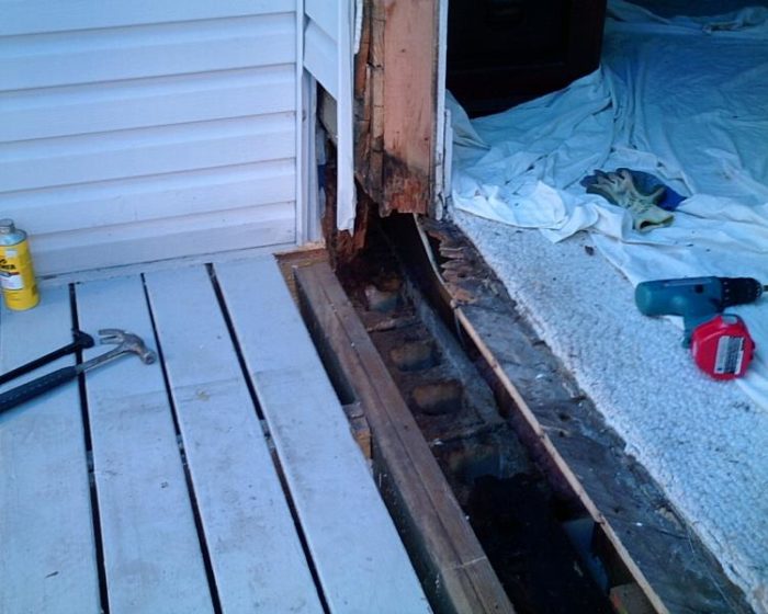

See the picture for what happens when they (the flashers) forget to show up before the door’s installed….when I took the thing out, I first thought the only thing wrong was that the finger-jointed brick mould had rooted out (like it always seems to)….took off the interior casing (nailed only at the jamb, with panel nails!)….not a lick of foam or fiberglass, no nails throug the jamb….but by God the brickmould was glued to the sheathing!

What is your plan to fix this mess ?

Almost done....it's my cousins house & they are selling and relocating to Hot'Lanta, so I did the best job for the least money possible....sistered in new sill plate, pegged to treated blocks in the CMU foundation, sistered in new doubled band joist, Dutchman in the bottom 8 inches of the jack, got as much Grace peel & stick around the opening as I could, set the door on sill pan, foamed everywhere I could & called it done

How old is that house?
I am seeing 1x sheating over framing and some type of wood lap siding over the sheathing, followed by the drop in foam and vinyl siding.
The door may have benn installed only five years ago, and added to a problem that existed before the vinyl hid it all.
The hack that installed the door may not be the only one that worked on that place.
You just got to fix stuff left by a couple of decades of them.

"I am seeing 1x sheating over framing and some type of wood lap siding over the sheathing, followed by the drop in foam and vinyl siding."Yup, that's exactly what you're seeing.....now, the corner you saw in the picture was the side of a new addition, same age as the siding & door install....so the wall the door is in was originally the back wall of the house...there was a window where the door is now
So, it's possible there was some rot coming down from the old window, but I doubt it....the snow gets pretty deep up here, & I'm betting it piled up in that corner & then melted right down past the non-existant flashing.
Been There Found that...No chimney Flashing....8 feet of wall, top plate to sill, GONE
That vinyl siding sure does keep things hidden well. That much damage takes time....
