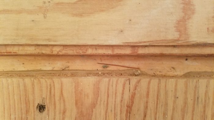

House was build in 94, two story cape.  On first floor, cracks in ceiling, gotten worse over the years.  Recently took up carpets upstairs (probably was put down to hid crack, when house was constructed).  Crack in floor, the length of the house (30 Feet).  On outside walls is 9/16, in center (where stairs are), 1  and 5/16 inch.  One side of split higher than other (poss 1/4 inch).   This is basically where the center beam in the cellar of house is, but nothing appears to be wrong in cellar.
Various thoughts on how to fix.  Sand down and seal the crack (not sure that this will prevent further cracks).  Or, cut back the floor, on both sides of crack (a foot or more on each side), and put down new floor (nailed and glued), to better hold bother sides together (probably will still need some sanding to get level)…or what?  See attached image.

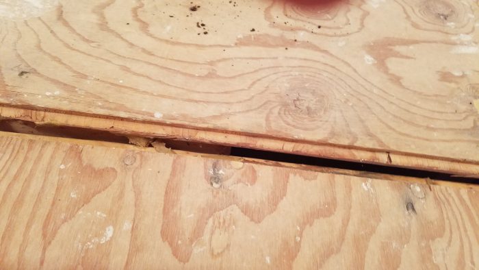

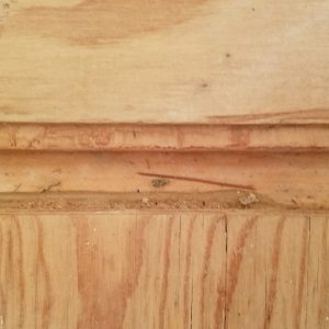

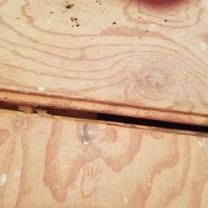

    You sure there is a crack? From the pic (hard to see clearly zooming in close) it looks like they changed direction of the subfloor and sheets were installed tight to the tongue. The tongue should have been cut off, so sheets could be installed tight. It looks kind of strange that they would change direction of the subfloor (and possibly joists as well), but you do often see a change of direction of joists in more cut up homes. Without knowing the story with all of that it’s hard to tell, but structural you may be fine. Do the cracks on first floor line up exactly where the seam is?
  6. Geoffrey | Aug 02, 2020 11:46am | #6
    That is NOT a "crack" in the sub-floor it is simply a space that was created when they changed the direction on the sheathing. The left side is running vertically or top to bottom, the right side is running horizontally or right to left due to the fact the joists are running in perpendicular directions on each side of the beam, just fill the gaps with some strips of plywood and leveling compound and be done with it.

  7. whois | Aug 03, 2020 05:46pm | #7

    As noted in later posts, the subfloor was put down in different directions. In the image, on the left side, the subfloor runs parallel to the crack\split, and thus the joists are perpendicular, nailed at 16 inches. On the right side of the split, the subfloor is perpendicular to the split, and thus the joints run parallel to the split, and are nailed every 12 inches.

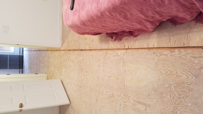

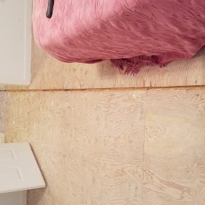

    I have attached 1 image here (could attach a series of images from basement, to ceiling cracks, and more of the split), but it would be 25/30 MB. I will attach 1 image with the reply. It is the center (where the stairs are). In an additional posting I will attach an images from the room with the bed, and it is total different in that you do not see a joist going across the split, and you can actually see into the floor.

    Here is the second image...
