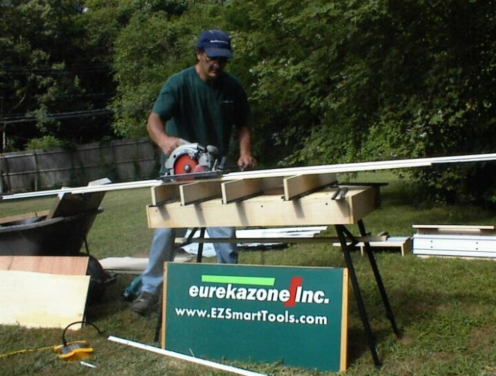

Are you thinking EZ guide?

If you do a lot of this sort of thing it may be worth your while to research the edge guide systems as EZ Guide or the Festool set-up.

I have pieces of thick-stock (I think it's just plastic laminate that's 1/2" thick) eight foot long that serves as a straight edge.
Ya, that'll do it.
