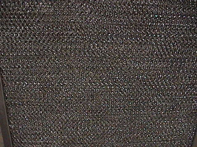

#1, replace any washable style filters right away. Measure them for replacement then throw them away. (see jpg1) It is imposes future problems with your system. It is very porous and the accumulative matter can and will creep through this wide of material. The collection will occur on the evaporator coil webs over time and freeze up the system, this is the first symptom of sick air flow. Replace it with a medium ranged filter, my best advice here. CHECK it every week.

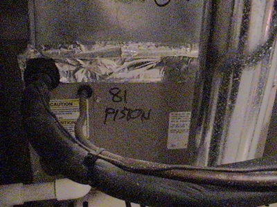

#2, The gas fired heat and exhaust fumes are hitting your evaporator coil in the winter. Thus welding on foreign matter on the fins that cannot be easily removed without caustic solvents or just plain galvanic removal, which never happens so you have to have completely have new
installed. This is a forced air system, evaporator coils in top part. (see jpg2)

If your combustion exhaust fumes are hitting your evaporator coil, your system is not installed correctly. The gas fired combustion is inside a heat exchanger, and then to a flue and out. No fumes should be mixing with air handler air. Paul
