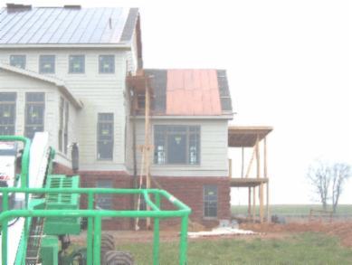

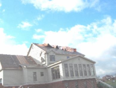

It's hard to tell from the pictures, but it doesn't look like any fun at all. Is that standing seam copper? It looks like it got pulled up and crumpled, but not blown completely off the building. It looks like seams stayed together, but many of the cleats pulled free of the deck.
Right now I'm making cleats and pans for my roof, and we've had some high winds, too. Maybe I should be thinking about closer than one per foot?
-- J.S.
Yeah, it's SS copper. My installer got in a hurry and didn't install as many cleats as he should have. One row had two cleats on a 10' pan. They're supposed to be cleated at 16" OC min. The two closest ones I found on the rolled up section were 22". This guy's been working for me for 7-8 years. Somebody offered him more money so he got in a hurry to get to the next job. Haste makes waste.

It sounds like a progressive failure situation. The wind gets under an edge and lifts some copper. The more area it lifts, the more area it has to push on, the more force it can apply to the remaining cleats. The seams holding together only prevent an automatic reduction in the force. I think I'll stick with 12" O.C. and even closer at the edges.

How are you going to salvage it?
What I mean is, you have to pull it off to install the clips that aren't under the remainder of it? How can you get it off without ruining it?
I'm missing something here.......the seams have to come apart to do this?
I'm kinda surprised his ins co is gonna cover it. He has a Shoddy Work Policy?
Joe H
There isn't any salvaging it. The customer is paying for a new copper roof, properly installed. What didn't get ripped off is not installed correctly, but it is turning water for the time being. When I get the rest of the house dried in, I'll come back and remove the whole plane and reroof it. The client is very sympathetic, fortunately. I've been out there all day today and yesterday and have gotten a great deal of roof installed. As far as insurance goes, my sub is probably lying to me and/or the insurance company. This is gonna get ugly, but I'll keep the client happy and deal with the lawsuits when necessary.

Initially, I thought I might be able to save what's still on, but if the part that blew off was not fastened correctly, then the rest of it is not either.
Would it be possible to get the remaining part off by cutting thru the seams? Could it be salvaged that way as strips of flat stock, too narrow for this job, but perhaps useful for something smaller? Could the moderately mangled parts get re-cut into cleats? (not that you need all that many cleats, but as an instructive exercise for the guy who didn't use enough cleats ;-) )

The seams are all that'll go in as scrap. The flats will get made into drip edge, step flashings, cleats, counter flags, what ever. It's still nice and shiney on the back.
