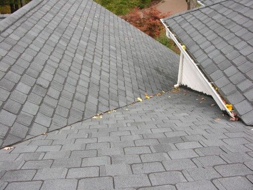

For one, the valley flashingsa are only maybe 6″ wide and are covered by the shingles insead of being uncovered as shown in the manual. Furthermore, the shingles were not woven into each other (as I have seen on others roofs where there was no metal visible in the valley). Instead, the shingles were cut along the length of the valley on both sides, then sealed with tar. Is this normal?

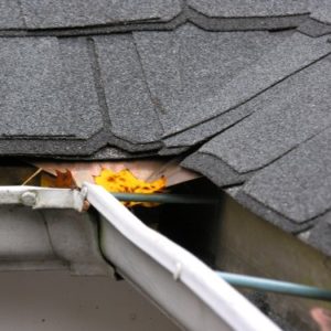

I was also not impressed with the trimming of the copper under the valleys, as it extends into the gutter. I presume this will just lead to widespread overshooting of the corner. Nevermind, the adhesive release strips I still found attached to the shingles and the cover someone installed at the bottom of the roof valley (the pic with the banister), causing all the water to run down the wall.

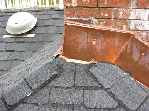

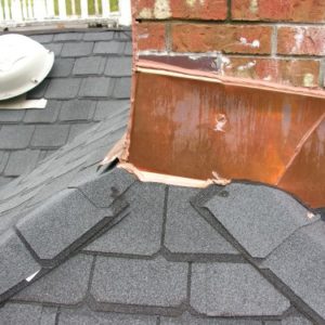

The flashings around the real and fake chimneys diverges also, with none of the steps one usually finds along the edge between the chimney and the roof shingles. As installed, I suspect that the water runs down the face of the chimney and is then sucked under the shingles through capillary or whatever action.

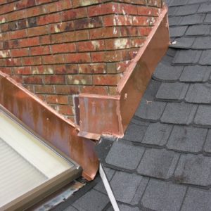

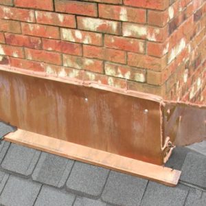

      Hi Mike,At least one side is cut overlapping slightly - imagine an offset running down the lenght of the valley, maybe 0.5" from the center - then seal the seam with tar. I have enclosed another set of pics that shows a different valley in better detail.The roof is maybe 3 months old. They've had a dry summer, so I imagine that was the saving grace until now. The homeowners also know they need new gutters, but I guess I would have done it all at once or not at all. The flashing against the walls with tar and the chimney's is off, no? I simply note how the old flashing (still lurking under the new stuff against the chimney) was applied per the instructions from CertainTeed in a step-wise manner.The location is NJ. I hope that this can be fixed w/o ripping most of the roof off. Also, what could cause ridges to leak?

    well, i'd be surprised if there wasn't a leak in this picture ..
    we'd never flash a chimney that way here ... that's a cut reglet and one piece flashing ... but i do know that it is often done in other parts of the country
    this is how a typical chimney would be flashed here..
    as for valleys .... the grand manor is too thick to weave.. so it should either be an open valley  ( metal  ) or a California cut  ( minor roof turns up the major roof , and major roof gets cut neat in the valley line .... major roof sheds onto minor roof )
    but i'd have to check my Certainteed manual for their required valley install... Grand Manor may have some peculiar requirements
