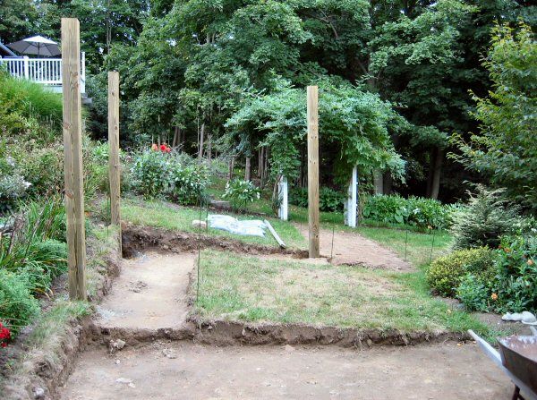

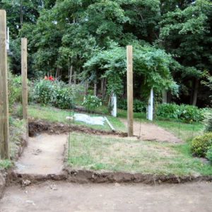

          1. DickK | Sep 27, 2005 03:13am | #24
            Very uncooperative weather - heat during August and first of September, but I have finally gotten started.  To all who said to stay away from concrete and use crushed stone, thanks.  I have found it is actually easier to pack the stone rather than mix the concrete.
            Anyway, a lot of work yet to be done, 13 more posts to start.  Hope the pergola is done by Thanksgiving and the winter is on the mild side.  There is quite a bit of dry stacked stone wall to build.
          2. Danno | Sep 27, 2005 03:43am | #25
            Thanks for posting the picture. Can't wait to see how it looks when you've got it completed.
