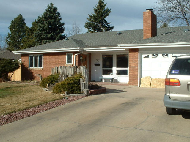

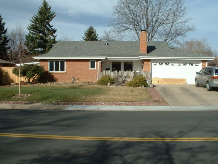

Here are some shots of the house from the street. Looking at the house form the street the hip on the left is where we want to have french doors onening out onto a patio with a low wall around it with something above it for shade and shelter. I’ve been thinking a gable end would work better but am not set on it. Behind that brick wall is a small dinning room and then behind that is a small kitchen.
What atyle does this house have? What style would work with the shape and materials there? We are planning on getting an architect/designer to draw up some elevations and other plans but I need to do some homework before that. Right?
Looks like a bricked ranch to me.

I'll go out an a limb here and say it's a brick ranch ;-)The depth of the overhang and the horizontal feel are slightly prairie-school influenced, but nothing else about it has any particular style. I've seen unassuming ranches totally transformed into something Frank Lloyd Wright could have done, but not without radical changes in the windows and materials and rooflines. Still one story, but you would never know it was a generic ranch to start with. But they were definately architect-designed projects that took a lot of money to accomplish.Barring a radical re-do, which seems to be all the rage for ranch-house remodels, there's not much to do when you add on to the exterior except keep anything you add on from getting out of proportion with the rest of it. If you opt to go up rather than out, than you might as well transform it completely, since by definition, it would no longer be a ranch.If you want to keep it one-story, and add on in keeping with what's there, then I would basically just follow the cues of what's already there. Keep any new rooflines that intersect with the eave sides of the house as hipped, like the two legs on the front of the house. Rooflines off the gable ends might work as a shed, if they stay under the gable-end roof soffit, but would probably look better hipped as well. Match depths on the soffits and fascia.As to materials, you could go with more brick, but it would probably look good to mix some siding in there instead, picking up on what's on the house around the front door. Probably should stick with casement windows, though you could certainly get more generous in the amount of glass in whatever you add on.Interior is totally up for grabs. What's there now? Unfortunately most trim from that era is pretty uninspired. Probably just clamshell on everything. Unless it's all original and pleasantly done, I would be tempted to come up with something a little more interesting, but not outlandish.Steve
it would lend itself to "bungalow style".... see " craftsman"or " greene & greene"i see a low pitched covered entry and reorient the front walk to approach from the front istead of being an adjunct of the garageMike Smith Rhode Island : Design / Build / Repair / Restore

I'm looking at the photos thinking brick ranch.

Looks like a u shaped suburban ranch with a hip roof. :)

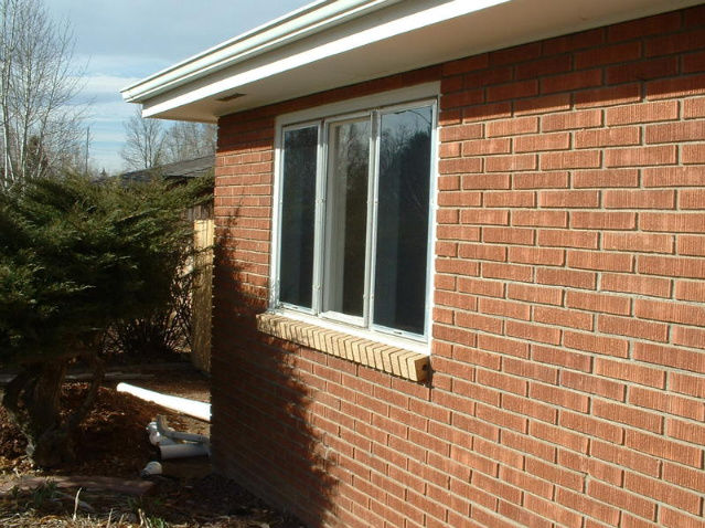

I'll take some pics of some details after church. It's Easter!
Brick, modified hip roofed "U" ranch snout house. Pretty much what my parents own, circa 1961.
It's a nicely proportioned ranch. Good roof lines, quality brick work. Other than the fake wharf/seaside feature, it all fits together fine.

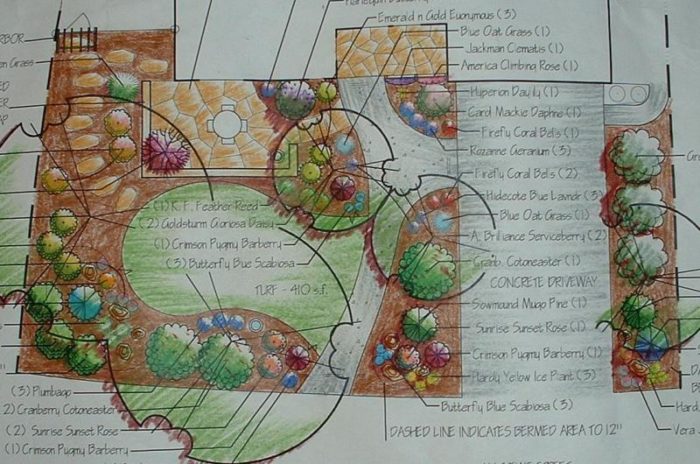

The wharf thing is going away soon. We had a landscape designer do a plan for us. If you want me re-size it i can. I just wanted to show some of the detail. You can see the patio in stone with a wall in the front and sides. There is no overhang or anything architectural over it. I need some way to shade that area and tie it into the house. Pergola?I could do a smaller one where the designer drew in an arbor in the upper left corner. It might help tie it in so it doesn't look out of place.

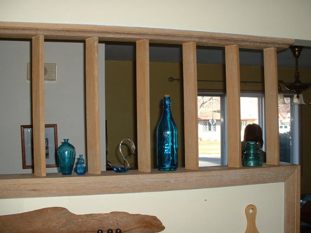

On the inside is some stone work that comes from a local quarry. I plan on facing the patio wall inside and out in this stone and pattern. It does kind of have an art deco feel to it. Is art deco an older style that came up in post modern ranches? We could do some details like that.

That interior is more Midcentury style then Art Deco, and the house would fall into that catagory as well.

Definately some nice mid-century modern going on there. More than your run of the mill clamshell. I like the original treatments. I would imitate that in whatever you build.Steve

BTW, that landscaper's drawing looks like a winner to me. Please post some photos of the work as it progresses.
