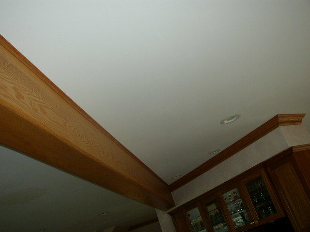

            When I replaced a a load bearing wall in my house (26') I checked out all my options. Engineered lumber would have been ~18" deep and had to be tripled. Mtrl cost ~$1200. I was able to buy a 10W26 I-beam for $280 that had 2.5x the strength, and obviously only 9.75 deep. By going that route, I was able to cantilever it 4', opening up a host of new floor plan possibilities not available with wood.
            You say that,
            "maybe just in this area, at least one county won't inspect structural steel, probably because their personnel don't know what they are looking at,"
            How hard is it to pull out some span charts. You don't need to be an engineer to calculate that stuff. It's simple arithmetic. $ for $, using steel for longer spans is often, IMO, the most cost effective solution if it is easily available.
            I'm posting a pic of the completed job.

            BTW, Thanks for the comment on my oak covered I-beam. Incidentally, is is covered in solid  boxed 3/4" red oak, bonded to the bottom of the I-beam with a bed of RTV silicone. The bottom corners were beveled in such a way as so that the glue line is hidden. Every one who sees them (there are two beams) thinks that they are solid beams.

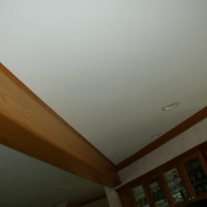

          7. WorkshopJon | Jun 09, 2003 02:56am | #14
            A slightly better pic
