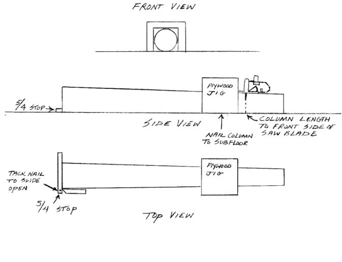

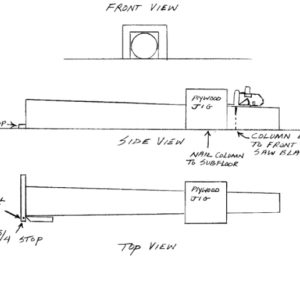

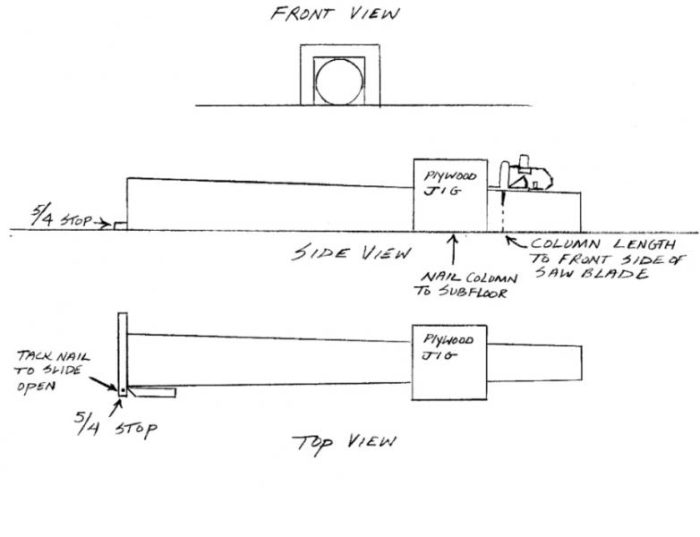

  8. Framer | Jun 14, 2003 03:44pm | #8
    Ron,
    Years ago I had to cut a bunch of tapered columns and I set up a plywood jig probably similar to what Ricky said.
    I made a four sided plywood box. I then marked the column length to the top of the column and measured back towards the bottom the thickness of my saw table to the front of the blade and marked that.
    From that mark I measured the thickness of the column and marked it on the plywood jig and cut out a square slightly big so you have room to spin the column.
    That mark is where I nailed the plywood jig to the subfloor and down towards the bottom of the column.
    The bottom of the column has a couple pieces of 5/4 as a stop.
    Then I put the saw on top of the column up against the plwood jig and used that as a Fence and then cut the column and spinnong it until I was done.
    If you have alot of columns it's worth it. To make the jig and set it up takes a lot less time then what I explained.
    You can cut the columns by yourself this way.
    Joe Carola
  9. Framer | Jun 14, 2003 03:47pm | #9
    Resize Drawing.
    Joe Carola
