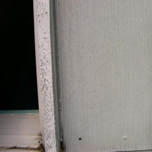

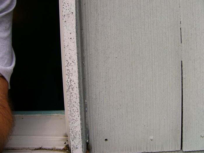

My neighbors Andersen window has a sash that has basically fallen apart.  He wants to replace the window with minimal destruction (i.e. don’t remove the exterior cement/asbestos siding).  Also he wants wood interior sash with no maintenance exterior (vinyl prefered).  Jeld-Wen has something – wood interior painted alum exterior, replacement sashes with jamb liners.

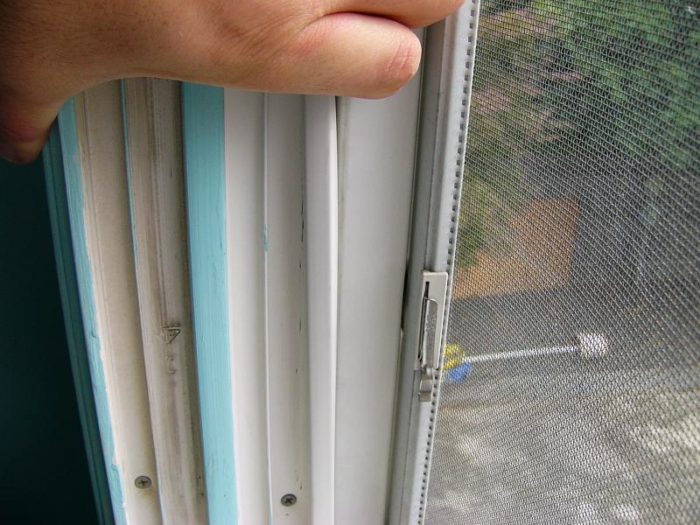

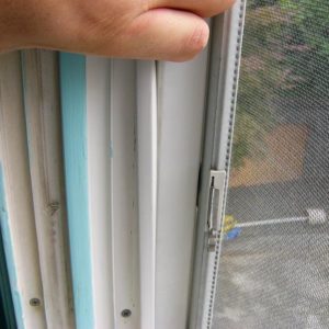

How does one remove the guts of this window?  If the jamb screws (see photo) are removed will the jamb tracks come out and enable a “replacement” window to be installed without removing the rest of the window and any of those asbestos shingles?  Will the guts be able to be put it back after proper measurements for replacements so the window operates until replacements arrive? Or will the guts “sproing” apart and not go back together?
Another possible option?  Can just new Andersen sashes be installed?

    Looks as if you have already removed the bad sash from the window frame.
    The sash glides and balances will come out if you remove the glide screws and the plastic trim liners. Behind the top trim in the head frame will be the balance mechanism for each side...it can be removed or replaced.
    As Piffin said...all parts are available.....but call for your local rep because as mentioned there are some series of windows that still have replacement warranties in place due to faulty manufacturing specs.
    From the looks of the window in the second photos the sill is probably rotted away under the vinyl.....check it out fro the inside by removing the lower window mouldings and probing the sill.
    If the sill is shot then you will need to look at a complete replacement and this will probably involve the cement siding that you were hoping not to disturb.
    I would suspect the siding/window juncture allowed water to migrate into the frame and slowly rot away the wooden backer parts.

    Here in Texas,  I consider our market in window replacements far behind the north, but we can tear out any-thin,,,On your interior,remove any and all jambs and returns other than the actual window parts ,remove the active sashes, remove the fixed sash,(if you must eliminate it pane by pane) collapse the frame by prying (from interior) the or a piece of the frame away from the building frame,we "break out" aluminum frames here starting with a sawzall at this point... after the first side it crumbles like devil's food...the nailing flanges are usually never any thing tougher than aluminum and when persuaded this way will eventually let go of the nails...Never having opened the siding or trim...
