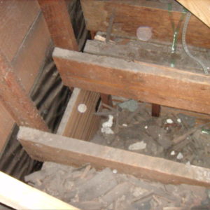

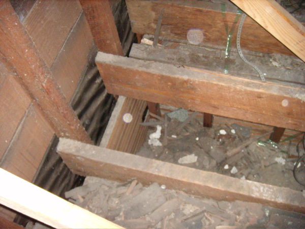

          1. KHWillets | Jan 06, 2009 08:56am | #16
            I have a similar problem. Not just the stud bays, but I have big voids like this one above a closet. You can see all the open lath and interesting ventilation paths. Are there any good ways to deal with these? I've been putting sheetrock panels across the big ones.
            BillHartmann | Jan 06, 2009 11:26pm | #20
            For holes upto 1-2" you can used canned foam.For larger areas you can get foam sheets (blue board/pink board) and cut to fit and then seal with the canned foam..
