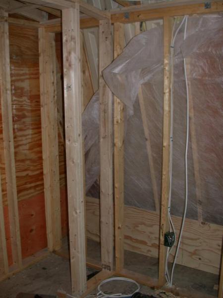

you blow it into kneewalls by creating insulating areas... here's a pic of one created by using 2x8 rafters, a plywood kneewall and insulmesh on the rafter face..
as to cathedral ceilings.. you can create boxes out of the joist spaces by using foam board, insul. mesh, furring , drywall, or blueboard.. you can drill 1" holes, 2" holes, 3" or 4" holes, you can leave out strips... you can insulate it from the roof by leaving rows of plywood loose....
your imagination is the only limiting factor...Mike Smith Rhode Island : Design / Build / Repair / Restore

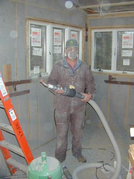

Either way, ask the guy in the pic>>>

Blown is fine in a perfect word, but you have to rely on the installers. Ask dusty boy why he is holding the wand...
"Are we talking walls or ceilings?" Either, one.
Mike - why are you holding that wand? Is that a blower, or vacumn? You didn't appropriate Helen's Rainbow again, did you?
it's magic, jim......
just like cellulose insulation.. ya gotta believeMike Smith Rhode Island : Design / Build / Repair / Restore
You haven't been performing any medical tasks on the subs with that thing, have you?
