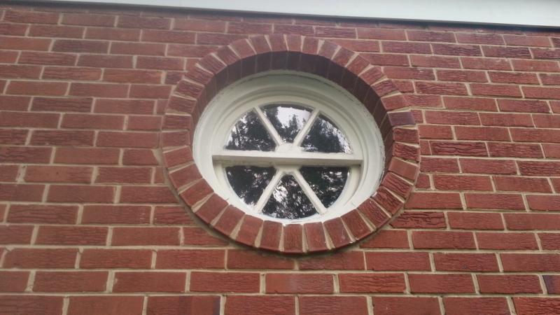

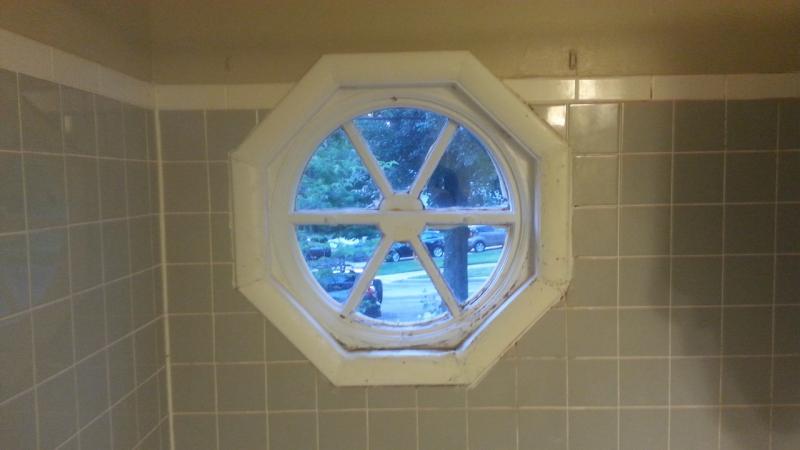

Anyone good with replacing specialty windows? We need to replace this octagon window but I’m not sure what to call it.
An octagon frame inside (outside is round) with a round divided window. What do we look/ask for?

    If you don't need an operable window it should be fairly easy for a millwork shop or some such to create a new frame, and a glass shop could cut the circular or octagonal glass.  Overlay with dummy muntins.
    Operable, of course, would be more of a challenge.

    MarkH: That's more the direction I was hoping for. So it's a round window and I'd need to find a way to mount it inside an octagonal frame. Or would it be relatively easy to go with a round frame/trim inside - something prefab? The inside walls are plaster & lath and form an octagonal hole.

      Unless you get extraordinarily lucky and find an exact match, you're going to have to do some custom work.  Your main challenge is to get as good a fit as possible to the existing brick opening.
      (However, you could get lucky.  I have seen very similar windows a handful of times, and very likely there were only one or two manufacturers.  So the sizing may be relatively standard and someone may make a replacement.)

      That window indicated it came with adjustable interior trim, you might get lucky and it will overlap the existing trim, or actually cover the tile with the old trim removed.  Hard to say.  I would probably replace the octagon trim with a plastic version if you're forced to keep it.

        If the window is smaller, I think I have a relatively easy plan. Once I refinish or rebuild the octagonal frame, I can cut a piece of plywood to fit it and the circular window. I can put nailers in the corners left by the arc of the window and the corner of the rough opening and nail the plywood into place. Then it's a matter of caulking and trim work. The trim around the octagon is nothing more than moulding.
        At least that's the theory.

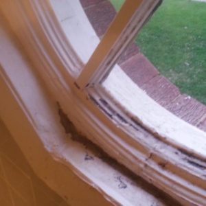

            dig out the rot, stabilize what you can and epoxy/pvc the rest back to life.  It'll be exactly the same as it always was from the road.
