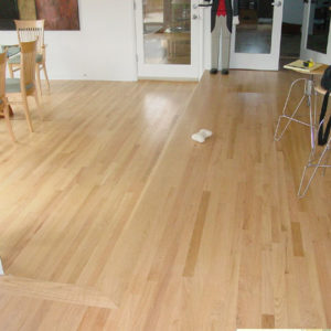

    Here's the operating theater...

        Change the color of the nosing to make it stick out?  Doesnt look like it drops much an inch or two?View ImageGo Jayhawks

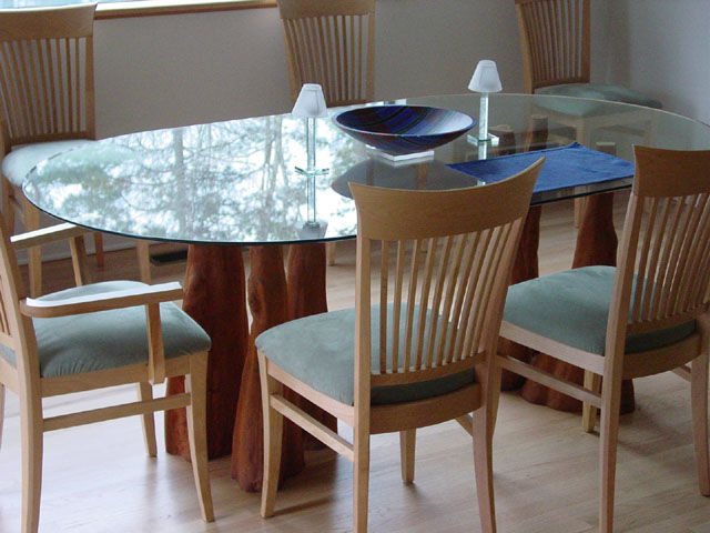

        I didn't even work on the house, but if you look around the corner, you can see the infamous cypress kneed table.

    The picture says it all, if there wasn't a door for scale, it would be hard to tell where the floor ended.
