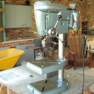

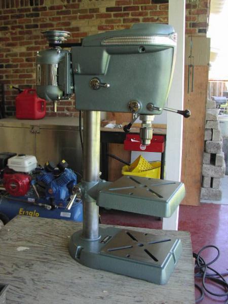

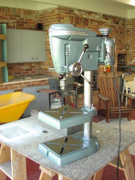

I recently posted about an old 1950’s drill press I found. Thought some might be interested in the finished product. New paint and bearings, some elbow grease and Flitz polish.
Good as new….but old. Wish I could say the same about me.

    basswood | Apr 23, 2006 04:49am | #2
    Looks like an Art Deco trophy. Nice.
      Gunner | Apr 23, 2006 04:56am | #4
        Yea Art Deco that's what I was thinking.
      Wop bop a loo bop a lop bam boom!
  3. Stuart | Apr 23, 2006 04:50am | #3
    Very nice!  I have the exact same drill press, along with the matching jointer.  You should post those pictures over on the old woodworking machines website at http://www.owwm.com/.  Incidentally, they have a copy of the factory manual for that drill press, at http://www.owwm.com/files/PDF/Craftsman/1950-103-23130.pdf.

      1. junkhound | Apr 23, 2006 06:00am | #9
        That's what I learned on.  Pop had one just like it (including the stripped motor housing) in 1948, and I think it was old then! Think it was his pop's before that.  My sister has it now.  Have a pix somewhere as me at about 3 YO drilling holes in a piece of 2x4.
        BTW, the late 1960 drill presses have very similar handle knobs, you may still be able to get a replacement for the one that is missing.

  8. JohnSprung | Apr 24, 2006 09:25pm | #14
    I, too, have the floor model of that machine.  Where'd you get bearings for it?
    -- J.S.
      PeterJ | Apr 24, 2006 10:06pm | #16
      Hi John
      Most old stuff I've restored has common sized bearings. Best bet (and who I use) is a bearing house. Around here that's Mcguire Bearing, Kamann or Motion Industries. I take the old ones in and they match up to current stuff dimensionally.  Incidently, six bearings,(2 quill, 2 motor, 2 quill shaft) tallied more than the machine cost in 1951. $95 for bearings, 74.95 would get this bought back then.
      All told, I have a tick over $200 plus my labor (don't ask), and some running around. All things considered, a pretty good deal, plus I get a bang out of restoring and using the old boogers.PJ
