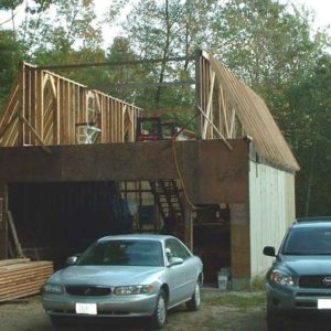

Hi all,
24×36 2-story gambrel garage.  Finally getting rafters in place after almost a year and a half of puttering around.  Lower rafters are on, plan on getting the uppers in place and hopefully some covering over that before we head to Hawaii in a couple weeks for our delayed honeymoon.
Anyway, how fussy do I need to be about the top of the rafters all being in one plane?
Full 2×6 – rough hemlock – on 16″ centers.  5/8 ply going on top.  Most rafters were pretty straight- a lot of them I couldn’t decide which way they were crowned (that surprised me).  I made all the cuts based on the top surface, so width variation wasn’t really an issue.
When I placed them, I used a 10′ straightedge to line up the top & bottom, shimming on the very few which needed it. So, most of the variation is due to crowning variations.  I haven’t seen anything that looks like more than 3/16″ out of plane.
I’m assuming that areas which stick up are worse than those which dip down.  I’ll take a power plane or belt sander to any of the high spots I need to, and can shim up low spots if necessary.
I wouldn’t worry at all, except that one side lines up with the driveway, so when I pull in, or anyone passing by, will be looking straight along the edge.  Planning on using architectural shingles (if I don’t choke on the price).

  2. Piffin | Oct 03, 2006 11:26pm | #3
    yer way overthinking this. 3/16" is great even for planed.
    That photo is too large and those trucks are not trucks!
    LOL
    1. DonNH | Oct 04, 2006 02:41am | #6
      My Tacoma is out of the picture on the left, the car in the middle is my parents', which will be gone tomorrow after I pick them up at the airport, and the new RAV4 on the right at least is the 6 cylinder, 269HP version, which replaces the minivan:)
      I deleted the too-big photo -- I had shrunk the file size, but didn't think to shrink the display size.
      It wouldn't let me paste in the smaller version after I deleted the original.

    SamT | Oct 04, 2006 02:04am | #5
    Nice picture.
    Now, if you'll shrink the picture so I can see all of the text on one screen, I'll be able to read what you said.
