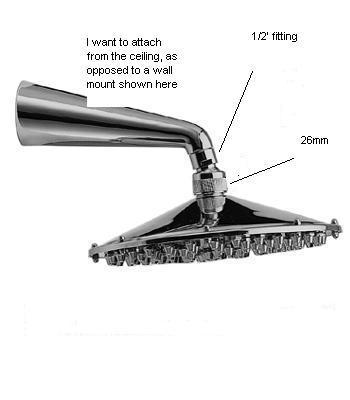

We are installing a 9″ diameter rainhead shower. The supplylines to the mixer and the output lines are 3/4″, however the connection on the shower is 1/2″. My question is this – will it detract from teh eprformance of the showerhead to have this constraint?
There is a 26mm metric thread on the head – has anyone had any success getting a chrome pipe made with a 3/4″ male on one end, and the 26mm female on the other? Any sources for such one-off stuff?

I bought the Jado showerhead - it has no restrictors, other than the reduction from 26mm to the 1/2" shower coupling - I thought about boring it out, but concluded that I would prefer to get a fitting made, if at all possible ...
