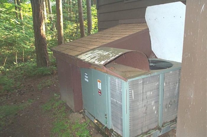

    In your case a good option would be what is called a packaged heat pump - everything is outside.  This is what I have at my own house outside Seattle.
    1/3 the heating bill of straight resistance heat, even vbetter if you add some insulation around the outside unit ducting to inside, etc.
     Went outside and took a pix for your perusal in the attachment.  The basic unit shown is a Rheem 4Ton packaged unit bought from Grainger for $2300 and 'roof'/insulation added . Heating bill for 5300 sq ft is about $120 month in the winter at 7 cents kWhr. Ducting runs out of the back of this unit into the house, which is where the most insulation is helpful.
    No freon license needed for packaged unit, but if you are a big DIY you can get a Freon licnse with a 25 question test (fairly simple) off the net for $20 even.
    This year and next is a GOOD time to do what you are proposing, as manufacture of units with F22 will cease in 2004 I recall.
    Good luck, if you DIY, e-mail me for more detail.
