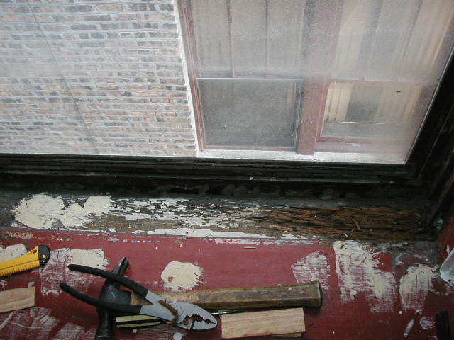

Can you post a photo?

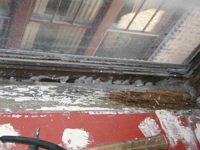

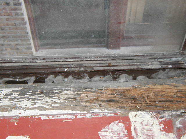

Here are a few pictures I have heard of the epoxy-is it hard to work with?

I've repaired worse using a two part epoxy, but you won't know the extent of the damage until excavating out all of the rot. You could use a chisel, as suggested, but I found that a rotary rasp chucked in a die grinder works best; it's fast and precise (or at least fairly accurate.)
Once the rot is completely removed, you need to decide if it's worth it to proceed with epoxy, or replacement. Generally, if the excavated area does not penetrate the sill, and is not too large, I will use the epoxy. Prior to mixing the epoxy, I fabricate 'dams' or 'forms' out of plywood that I screw to the sill once the epoxy is down as a make-shift form to keep the epoxy in place and form it to the shape of the sill, thus preventing a lot of sanding later. Wax paper is used between the forms and epoxy to prevent the epoxy from sticking to the plywood.
Prior to applying the epoxy (Minwax makes a good two-parter, though I buy Bondo by the gallon) I usually screw in a few screws into the excavated area to give a little 'tooth' to the epoxy. Also, Minwax makes a hardener which should be applied to all areas to be epoxied. It might take several hours for the hardener to cure enough to be coated.
Mix and apply your epoxy (I usually apply it in about 1/2" coats,) lay wax paper over it, and screw down your forms. Wear a mask and sand it smooth using a power sander. Apply primer and paint as soon as practical.
Of course, by the time you do all of that, it might be easier to just replace it, depending on if you need to fab a sill or can buy a reasonable facsimile.
Nick gives good instructions for using epoxy, but I suggest Abatron epoxy over Bondo. It is designed for exterior wood use, and I believe you can apply the epoxy right over the consolidant without waiting for it to set up. I haven't tried the Minwax products.
They sell the wood restoration as a kit w/ the liquid epox and epoxy paste together.
