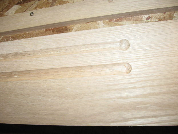

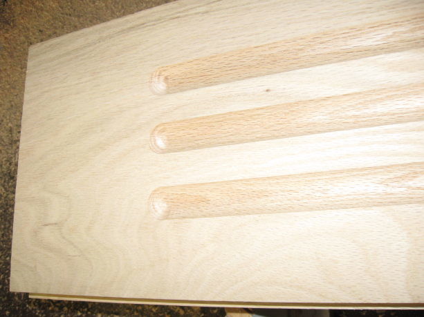

I developed a new technique yesterday:
“Thermometer Bulb” approach to Fluting without burning the flute ends. I use several light passes to minimize heating and before the final pass, I plunge straight down and back up, quickly, at both flute ends.
With all the material removed from the ends, there is no pausing and burning at the ends during the final pass.
I did 27 flutes yesterday in a couple of hours, and virtually no burning.

Neat. And in oak, yet, which burns when you look at it wrong.

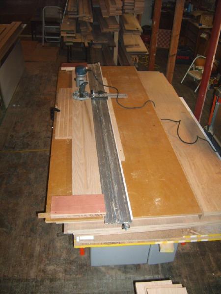

How is your jig set up? I usually use a router table setup for flutes, which yields some inconsistentsies/burn marks.
I've set the jig up a few different ways. Here are a couple of pictures:
Brian,Nice set-up. I know you are matching existing millwork. For non-column flutes I run the flutes through the ends, set the bottom on a plinth and a small piece of non-fluted stock on the top. The transition is covered with trim.Thanx for sharing the clip and tip.Chuck Slive, work, build, ...better with wood
Funny , the different approaches. I scoop a smidge with a gouge to both rid any burn and taper the stop point just a smidge.Spheramid Enterprises Architectural Woodworks

Good point on fluted stock landing on a plinth. For stopped flutes, this new approach (I just tried a couple of days ago), is working well.Cheers,Brian

Do you get much lateral play with the guide way out like that?
Looks like it would bind, but obviously doesn't.

The guide is way out because I am fluting a dozen 14" column faces too (the one in the video is for an 8x8 column), so the rail is back out of the way, but I like having the router close to me for control.I have learned a few tricks to preventing binding:Telfon Dry Lube on the track.If moving the router to the right, pull lightly toward toward yourself with the right router handle and push away from yourself very slightly with the left handle, as you go.Visa versa, for moving left. Works pretty well.

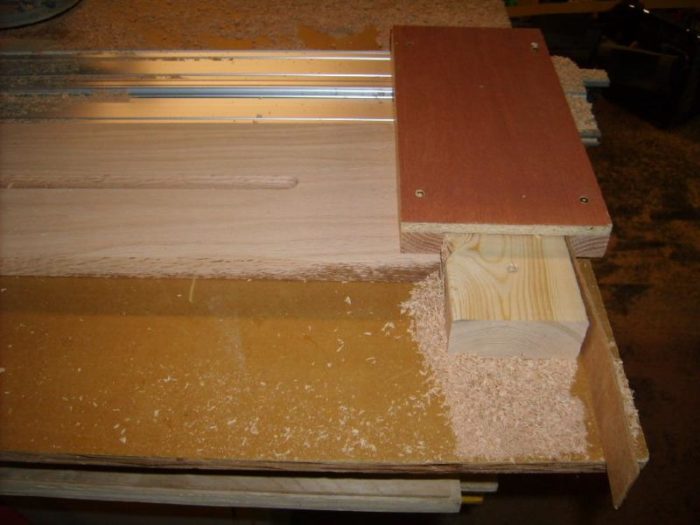

Also, I didn't understand how you were holding down the stops with the dowels from looking at the video.

The things that look like dowels in the video are vinyl j channel that I used like shims with the long leg of the "j" wedging the stop block onto a 2x4 cleat... hard to explain.
That makes sense. Great idea!How can you understand God if you can't understand people? How can you understand people if you can't understand yourself?

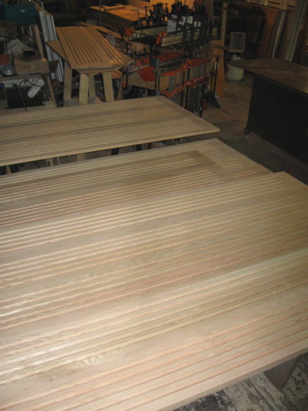

Here is my last batch of fluting (about 90 flutes). Glad to be done.
Looks like you have earned the title of "Accomplished Flautist"
