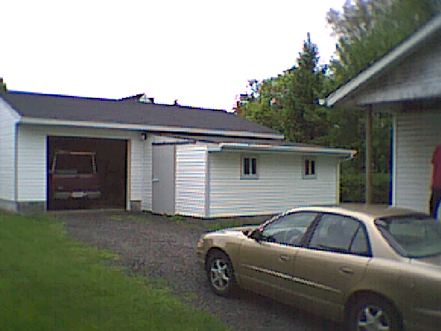

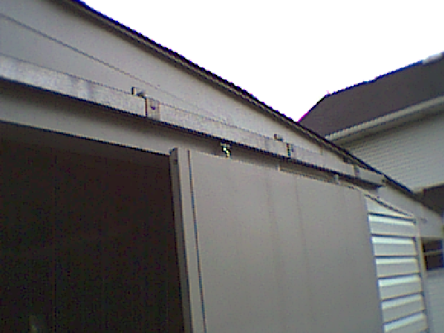

            Don't know the name of this track, but here is what I used on my shed that I attached to my garage. I used the rollers that attach to my door by drilling ahole through the door top. I cut out acces holes on the interior side of the door so I could adjust /or change these rollers if they ever got bad. You'll notice the light shining artound this door..as earlier mentioned, this set-up is a bit drafty...but it works for me in my situation.
            Davo
