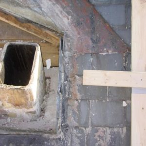

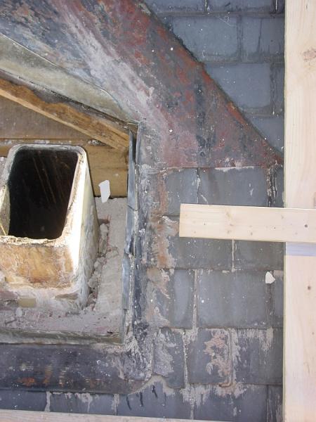

Nope this isn’t outhouse humor ! House I’ll be doing a big slate job on is having a chimney rebuilt too.
I’ll be asked to reflash into the roof when the masons are done.

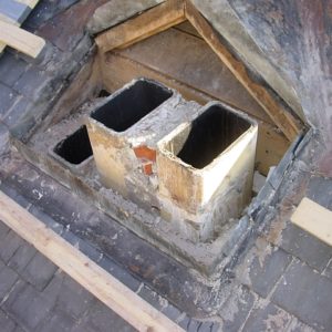

Whats wrong with the chimney itself ??

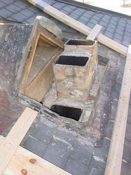

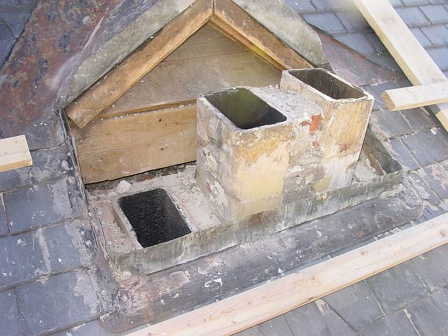

Space between the flue and the chimney, or flue to flue should not be packed tight with mortar. Does not allow expansion of the flues.
I don't like the framing up against the masonry, whick looks awfully inadequate. Could be code issues there.
Eric, Entirely correct on all fronts. House was built in the teens.
A fireplace on all three floors.
I couldn't believe it when I saw it. I thought the old geezers knew their stuff.

Walter,How much expansion space is needed between the flues?Old geezers? Piffin put this in as a kid? :)Looking forward to more of this thread.Best,Steve'Man who say it cannot be done should not interrupt man doing it' ~ Chinese proverb
Steve,
Typically masons leave an airspace around the flue tiles so that the exterior isn't going to move with the tiles expansion / contraction movements when the fireplaces are in use.
I think an inch is the norm , and two inches space between bricks and the framing.

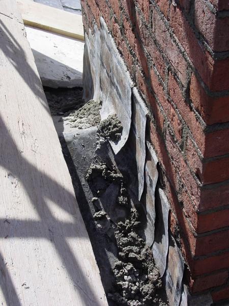

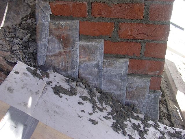

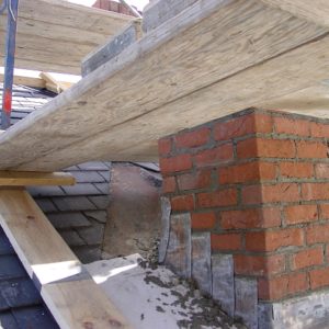

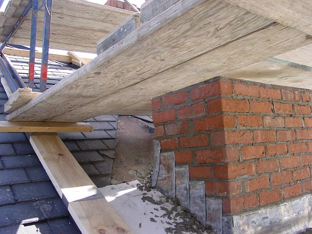

The masons did just as I asked to make my work easier once they're done.
This chimney will be parged with stucco to match the others and the house.
Several shots here of the lead counter flashings over the old galvanized base flashings.

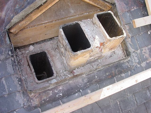

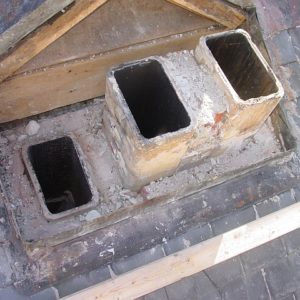

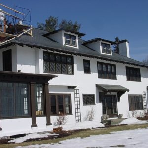

A couple more shots of the flues and the house itself.
seems like the house would look more at home in California than Maine - style of the time - thanks for the pictorial -

Yes it's a different style than most of our homes here.
I'll have to look up it's history in an excellent book on Bangor's architecture written by our local arch. historian
Walter
Save for those diamond pattern leaded windows.............if that house had a water table at the bottom and cedar shingles on the walls it would not look at all out of place. An old school house in fact!

Looking again, there is at least a brick wide around the flue.
I'm curious as to what the masons will do with this. have you spoken with them? Part of the reason the chimney disintegrated may have to do with is lack of mass.
I'd also be curious to see the confluence of flues leading up from the three fire places.

I've shown the crew how I want them to install the lead counter flashings so it's easy for me to come in after them to redo the cricket and roof flashings in 20 oz. copper.
They are working directly for the owner so it's not my place to dictate how to proceed. The owner of the masonry co. asked me to reflash into the roof , over the phone - so I haven't met with him there only his crew.
