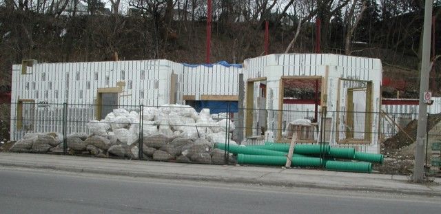

This is one incredibly expensive disaster. After a brutally cold winter and guys sloggin’ thru ice and snow, an ongoing construction project in our city is going to have be completely demolished. It’s enough to make a contractor go bankrupt. At the very least, an ulcer and many sleepless nights are sure to be coming this guy’s way!
ICF (insulated concrete forms) probably should be restricted to below grade applications anyway – window and door openings look extremely challenging on this project.
Anyway, concrete didn’t appear to have been vibrated when it was poured and other areas simply froze. What a b*gger to build in the cold! Too bad. Such a waste.

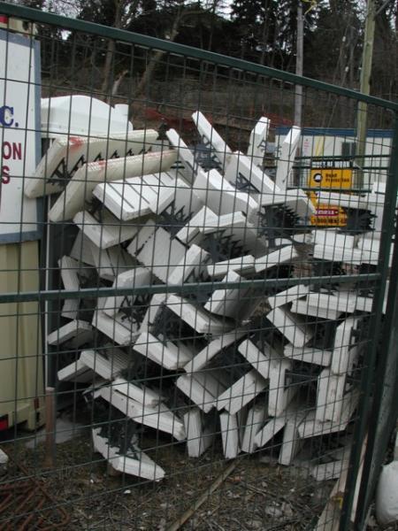

why do you say that the interior has to be furred out? we build tons of icf down here with the same system as in these pics{www.arxxbuild.com}. the drywall and siding screws to those black plastic ribs and we run an electric chainsaw with a depth wheel to make a perfect little notch for romex.the Arxx walls are just about the best around and we've never had any trouble, except with the concrete plant. icf is great in the cold and Arxx is based in Canada.it doesn't take a genius to build you just have to make sure you brace it good and take your time when you pour filling up the walls about a foot and a half all the way around and then going back over in circles again like that.using plenty of steel makes for great 16' headers that can support many more floors above.

Thanks for the info on the electrical rough-in. I visited the website you mentioned and it suggested: chainsaw, hot knife or angle grinder. That's pretty cool. I appreciate the info. I watched this site as it progressed (at a snail's pace) and it sometimes took days to a window opening formed and fitted. Such a difficult thing to estimate.

Poor (or complete lack of) vibration, and a way-too-low slump.
I'd have had it torn down too.
Question is, what clued them in that there were structural problems? I have no way of knowing if there's voids or honeycombing in my ICF basement walls, unless I tear off pieces of the ICF and look.
Hi Jon! Just a guess, but I'll bet that someone rapped the wall with a hammer and heard "bong" instead of "whump", as in a void in the system. Or else a trade start routing holes to install electrical or other utility and found a void behind the foam. The entire site is scaped away in places and virtually everywhere you look you see honeycomb or no concrete at all. Unreal. Imagine if they started putting the next floors on top of those walls and and it all collapsed. Wow!
