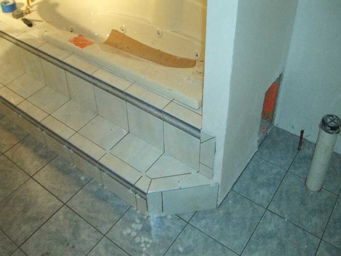

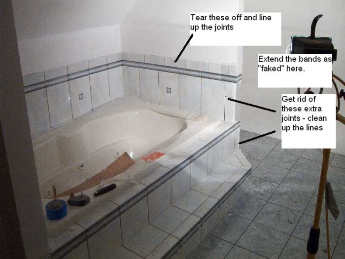

All right gang, I’m a bit out of my element here and need some advice. Please take a look at the attached pics of the tile work on my Jacuzzi surround.
I’m not happy with the corners of the work. By the corners I mean where the floor meets the angle of the step and where the step transitions up to the deck and then the deck to the wall. I can’t put my finger on what it is I don’t like, but I know there’s something that doesn’t look right. I need help explaining to my tile guy what it is I want there.
It seems to me that, for starters, the lastels (sp?) should wrap around the bottom of the step as it does across the front. It also seem that a better job should have done making all the grout lines line up at the corners.
I also don’t like how there isn’t one smooth line coming up the floor, along the edge of the step, up the face of the deck, and then tieing into the wall tile.
Am I being nit-picky? Or was there a better way to deal with these transitions? I don’t really know what is and isn’t possible with tile work. I can lay a basic floor myself, but I subbed out the tile because I wanted it done right. This doesn’t look right to me. In fact I think it looks like something I could’ve done myself! And that’s a tip off right there. LOL.
Half of me wants to let him finish and see how it looks before I interfere. The other half of me says it’s better to catch it now than wait until it involves more work to fix.
What say you all? We’ve been really happy with the other work he’s done. The shower in the background is coming out nicely with the exception of the ceiling can light that I think needs to be cut in a little tighter. We had him do two other rooms (other bathroom and laundry room) all the way to grout before we had him tackle the master bath. We are very happy with the work in the other rooms, but they are basic layouts in small rooms of floor tile.
Consensus?
The feature strip does not run around onto the 45-degree faces of the step.
The mitered joint on the vertical bullnose trim does not align with the corner of the field tile.
The field tile joints on the 45-degree face do not break in the same places as the trim on the steps
The 45-degree faces are 'wider' than the trim above... they could have been returned to the wall at 90 degrees so that the installation was all one width.
Now that you have seen problems you will probably always see them. If the tile was recently set it will pop right off and can be reset with the right cuts. If you let him grout it he will become very resistant to changing it. Think about it... when your lady is coaxing you into the new tub you do not want to be obsessing about tile problems... that stuff can seriously hamper performance! Pop off the offending tiles right now with a small flat bar and have him start resetting tomorrow. No blood no foul, it's your house.
Good. So you guys are seeing the same things as I am. That's a good thing because I feel like I've been staring at this damm addition for half my life and it's only been 3 1/2 months! I don't know how you GC guys do it.
So you're saying that it is possible to do it differently and make it look better? The tiles along the bottom step were just set today. (Yeah, I let them work on a Sunday). The floor was done on Friday and they wanted that done before the face of the step. Makes sense to me.

But I think that it would look better if the stripe on the first step would continue around the 45.
Don't have a clue what to do about the strip on the 2nd step and the surround walls.
They look kind of strange just stopping their.
And I don't like the look of the top row on the two sides of the surround. Don't know why he did not align those joints with the others.
I'm cloudy, take this with a grain of salt.
Did you have any corner bullnose? That would have made the upper tile buil nose line up on the outter edge of the tub. I understand why he didn't follow the lines at that corner, but you are right, doesn't look good when all the rest appears to line up.
The step, yup, the deco tile should wrap around.
There possibly should have maybe been a plane change on the front of the tub and the two side walls.........

I guess I see things like the others.
First riser - Trim or deco color should wrap corner. First tread - cut on bullnose at the 45 degree corner should match the vertical grout line of the tile on the first riser (and to the right on the other side). Second riser - 45 degree cut on surface bullnose should be altered to meet adjacent grout lines. Or, use larger surface bull, which normally comes the same size as field tile) cut to extend the tile to the corner of the wall. Some bullnose comes with the radius on two adjacent edges so you eliminate the need for that 45 degree cut.
Same for inside walls. Tile should extend to the outside corners or even wrap around.
I probably would have extended the tubs back wall tile to the pitch and I also like my tile all the way up so I would have extended the end wall tiles to the ceiling. Doing it that way does away with the need for a bullnose tile to frame in the field tile.
It looks like it was done by someone with a little tile experience, but probably just simple floor layouts. The joints mostly look good, and it looks like he tried to do a good job, but just didn't know how to handle the details
I'm bothered by the sliver of tile in front of the tub flange. Looks like a half-inch?
No its not you. It looks "horrendous"! Mainly the corner. Looks like it wasn't planned out "at all". Like he did it as he went along, not thinking two steps ahead.
Ralph gave you the right answers. Its really pretty simple and you could have done it better is my guess but one only has so much time in a day and you need to have other people do at least some of the other work.
Doesn't look too bad to rip off and redo at all.That corner is almost...no ..it IS laughable. Otherwise it looks as though he does decent work. Looks as though he needs to consult with you what is going to take place before he starts.

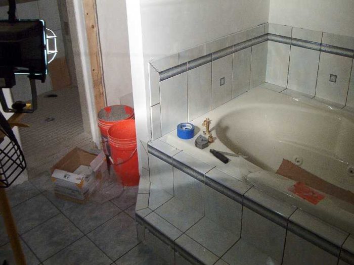

Also, the rainbow trout tiles up high above the tub look like they were somehow sucked up by reverse gravity directly against the border tiles. Perhaps if they were one field tile down they would look better to my eye. That's not a technical problem as are the 45 degree corners on the lower level, just thinking out loud.
Usually I'll at least mention to the client that if the floor tile is parallel to the walls, then they might think about having the tub surround field tiles at a diagonal, or visa versa. Just an option, or at least it was yesterday.
There's something else odd about the tile and it might be the border tiles. Perhaps this design would look better with some full size bull nose and eliminate some of the busy areas that don't contribute. It would be a cleaner look, if that's what you were after. Again, just nitpicking and I wouldn't expect anyone to change that at this point.
A technical issue that I wouldn't have done is the lack of caulk joints at any change in plane. The tile expands and contracts with heat, the framing does the same but also from seasonal moisture level changes, the floor will do what it does, etc., and the corners will develop hairline cracks without sanded caulking at those intersections. The first step in direct contact with the floor is the clue since a caulk joint needs to be more than a sliver in order to survive movement. If a .010" thick caulk joint moves .020" the caulk would have to survive stretching nearly twice it's length.
However, most residential tile isn't subjected to a great deal of moisture so you are ok as this is common practice in many places. Jackson Hole, with some of the nicest houses in the west, is an example of a town where essentially all the tile setters in town grout everything and rarely use sanded caulk, so you're in good company. Water will get sucked into the cracks in the grout, but it probably won't do any damage if the water barrier was done well.
Upon walking into a bathroom that has a lot of tile, or all tile, and grouted corners I used to bet the GC a buck that there were cracks in all the corners. They'd fall for it and get down close...and see a hairline crack! Then another and another. Tile subs love me. *chuckle*

Got any specific suggestions on what I can tell him to 'fix' it?
You might ask him to sketch the design on a piece of graph paper. Doesn't need to be blueprint quality, but just count squartes and sketch how the tiles will be laid out.
I thinkn I saw someone mention that the floor tiles and the step tile joints don't line up. Looks to me like they are different size tiles, so they never will align.
I wonder if it would look better if he took some of the floor tiles and ripped them top about 2" wide, and used tham as a base or toekick along the step. As is, it looks like the tub and steps were retrofitted to an existing room. It needs some kind of transition between the flor and the step.
Just another .02 worth but I think the feature strip should be mitered and returned on a vertical plane at all points in the tub and step area. And yes, as others have already pointed out, wrapped around those corners on the step. I think a lot of the distraction would be lessened with this minor detail and make a stronger visual statement without looking like it's hanging out there without an anchor point.

Also the floor tiles not meeting the grout lines of the tub tiles (I think you asked that) is fine the way it is. Its actually better IMO this way.

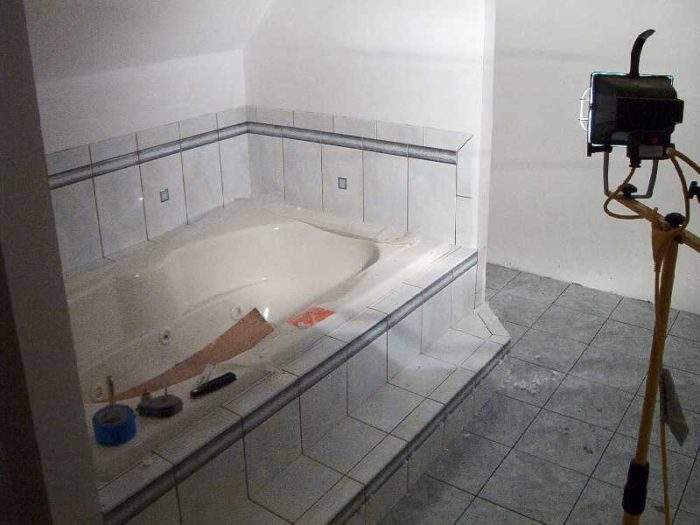

On the bottom step face, definitely run the face tile with the strip all the way around the corners and terminate them into the walls.
On the 2nd step and on the tile over the back of the tub, I see a problem with the "black stripe" terminating abruptly, ending at the cap tiles. Since the stripes are part of the tiles, I would have him cut the stripe out of a few tiles to make a feature strip. then I would use them as vertical returns, in a downward direction. That will get rid of the sudden ending.
As far as the non matching grout lines on the back, it can look good either way. What he did, by changing his pattern was call attention to it. have him remove the cap that don't line up and re-set them so they do (if that is the look you want).

OK - after all the other posts here, I'll weight in: it looks looks pretty poor. I would not want it in my home.
The main thing is that is has very un-clean lines and is too complicated. I would take a hammer to it and get the thing simplified.
I know this will be a pain to pursue with the guy, but I would do it.

usualy these tubs are within 4 or 5 inches of appropriate seating height. You sit on the ledge and swing your legs in the tub, I have had 4 of these things in houses i have built for myself. Wait until you need to clean the tub and you have to crawl up your steps and lean down in the thing, Or wait untilyou slip off the wettile step and bust your ####. Steps on whirlpool tubs are an 80s thing. I would like to see a picture of someone walking up their steps to their tub and the hermit crab position they need to get in to get down in the tub.http://www.shelladditions.com

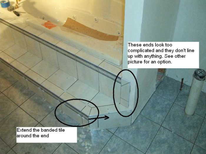

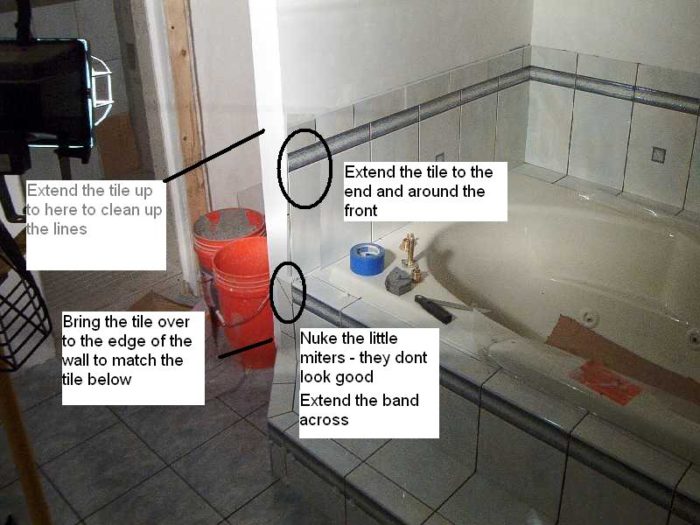

Specifically - see the attached pictures. Have your sub focus on aligning the joints where ever possible - that's "first day on the job" stuff.

Diesel - I'm a little late to the dance here and much of what I saw has been said. But FWIW I think carrying the dark line of the feature tile around the steps is a big improvement. The sudden termination of the dark stripe is real noticable. Since that stripe looks like it is part of the tile and not a separate strip, what do you think about having him cut a few strips out of the tiles, then use the dark strips as returns down (vertically, mitered into the horizontals) on the 2nd step and/or the walls? The cap tiles he used just don't do it. I think that would look better than just wrapping tiles across the front because the same problem will occur. You will still have horizontal stripes that just "end", only in a different location further out.
As far as the joint lines not lining up on the back - that's a question of taste. Depending on the tile, personally I sometimes will intentionally avoid lining them up. If he would have been consistent - either way - it would look better. On that one, tell him how you like it.

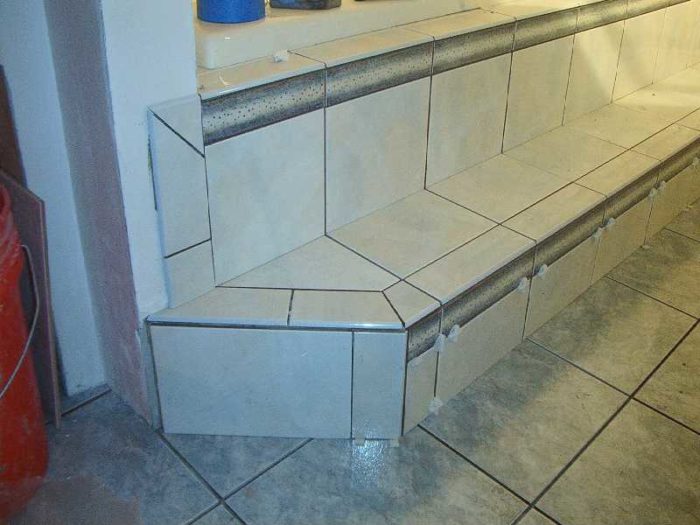

Just a thought here and a quick sketch of a possible corner return, diesel.
This design incorporates running the design tile around the corner and terminating it at the wall. It also allows the various runs of tile to match up as they work their way around the corner.

I stopped reading the replies, but I think you should consider floor tile on the tread of the step. That wall tile is going to be slippier than sh!t when done washing you a$$. I think it would help solve some of the awkwardness with the tile pattern.
Anyway, bullnose tile always look awkward to me. I know there is no other alternative. It just never lines up right. Just commenting in general.---------------------

Any chance of seeing the 'after' pics following the repair? Just like to see how your concerns were resolved. If you'd rather not, no problem-o.
Yer kidding, right Nick? We're happy with the way it was resolved and that was the goal of this thread.... making it look better without starting over. No way I'm throwing gas on the fire and giving the critics more ammo. I'd be happy to email one to you if you email me your address. Can't attach files through the site email.
Sorry my first response was "take a hammer to it" - I should have posted the suggestion pics right up front. It wasnt very constructive.
Good luck! If you have a solution that you like, that the most important thing.

It's all good Eddie... and that's a great looking floor. Where were you when I was interviewing tile subs? {G}
Me thinks it'll look fine, I'm not going to comment on the layout etc, you've been down that road, one thing to keep in mind, once it's grouted, so long as the grout reasonably matches the tile, most of the small imperfections you see now will dispear.
now some diehard tile fanatics will disagree and say grout won't mask problems...
that and most anyone you have over and looks at the bathroom, ain't gonna notice squat.
you want me to tell you a story about how we re-tiled this lady's backsplash 3 times till she liked it and it was "perfect" our tile sub was ready to kill someone ;)

Looks like you did a nice job on the Waterman tiles, but I can't stand the look. Are they metal finish?

I was gonna sk if the bullnose measured up "exactly" to the tiles ... lotsa times ... they don't ... and the tile guy gets a bad rap for using the materials he was given.
same deal with that border ... unfinished edges and all. Nice ideas to run it everywhere ... but I can see where he was left with an unfinished edge ...
looks to me like he decided to run the top of the rear splash ... then have everything else match that layout. Usually not a bad compromise.
as for the grout lines lining up from the floor to the walls behind the tub ... that's what I shoot for in my tile layouts. Tehn again ... I am a trim carp first and a tile sub second. I've subed miles of tiles ... and have worked around many miles than I've set ... and I've learned over the years ... a "tile sub" ... usually doesn't take the time to layout and shift as much as I do.
So yer first mistake was hiring aguy that's a professional tile sub!
How dare U!!
U shoulda found a trim carp turned tile artist ... who's bid was twice that of every other professional tile setter ... and who worked way slower too boot!
... maybe all them lines woulda lined up ... but ya still woulda kinda screwed the guy by throwing in that border that had no place to go.
To me ... that one can't be "made perfect" ... but I bet the re-do looks just fine.
